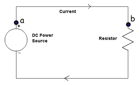

In an ideal circuit, How can there be a current b/w points a & b, when there is no potential difference and thus no electric field between a & b? If there is no current, then where does current across the resistor come from, because that means no charge is coming from the battery (?).

An electric field isn't necessarily required to sustain a current. Remember electric charge is accelerated by an electric field.
In the case of an ideal conductor, which is assumed to connect the source to the resistor, the current can be any value and the voltage across the conductor is identically zero.
This isn't a contradiction. Consider the motion of an object in the absence of friction. No force is required to sustain that motion (only to change it).
Analogously, in the absence of resistance in the ideal conductor, no electric field is required to sustain a current through.
If it helps, consider a non-ideal conductor with some total resistance R. The voltage across to sustain a current $I$ through is:
$$V = I\cdot R$$
Now, let $R$ go to zero and see that, for any value of $I$, the voltage across is zero.

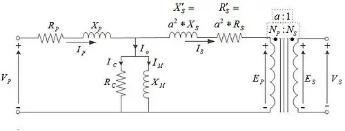

For example, here's the schematic symbol for an ideal transformer with the secondary connected to a load:
Unlike a real, i.e., physical transformer, the ideal transformer is lossless and has infinite bandwidth. How would one calculate or simulate a real transformer? By augmenting the ideal circuit schematic with additional ideal circuit elements that model the non-ideal characteristics.
For example, an ideal circuit model of a real transformer looks like this:
Note that every circuit element in that diagram is ideal and thus, isn't physically realizable but the entire ideal circuit corresponds to a good mathematical model of a real transformer that can used for calculations and simulations.

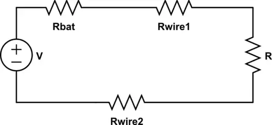

To further drive this point home, let's consider the OPs schematic as a "wiring" diagram for a physical battery connected with wires to a physical resistor.
Since this a DC circuit, a simple model of a battery is an ideal voltage source in series with some small value ideal resistor. A simple model of a physical wire is small value ideal resistor. Thus:
But, and again, each circuit element above is ideal including the wires that connect the ideal circuit elements.
And, again, for the ideal wire, there is no voltage across for any value of current through. This defines the ideal wire and that's really all that needs to be said about this.

Your question is difficult to answer exactly because of the assumptions you have to make for the ideal case. In the real world you can not have current flowing without an electrical field due to Ohm's Law where $\mathbf{J} = \sigma \mathbf{E}$.
You can try to argue in a perfect conductor $\sigma \rightarrow \infty$ so it doesn't matter what $\mathbf{E}$ is, but this is just the type of hand waving you can get away with only when you are talking "ideals". When you ask:
How can there be a current b/w points a & b , when there is no potential difference and thus no electric field between a & b ?
There is a subtlety in your question that I think is important to understand conceptually when learning circuits. And in fact you are correct to question it because current could not flow without a field, this is a requirement. However to simplify the model we often ignore it and this assumption works quite well for most cases however it can also lead to gross misunderstandings of conductivity in more complex situations.

There is some small potential difference between a and b, because conductors always have nonzero resistance (at room temperature).
