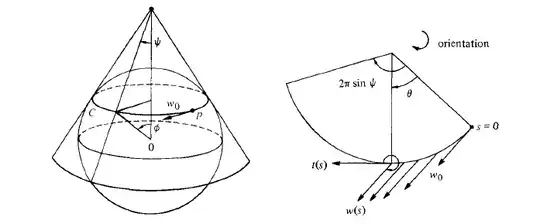

Both are trivial bundles, and the natural (metric) connection is flat (curvature-free) for both. The difference between them is that the holonomy of the tangent bundle of the cylinder is trivial while the holonomy of the tangent bundle of the truncated cone isn't. This means that in the case of the cylinder, the horizontal lift of any closed curve to any point of the bundle is closed, while in the case of the truncated cone, the horizontal lifts of nonshrinkable closed curves are not closed. To put it plainly, the parallel transport of any tangent vector around a closed curve in the case of the cylinder returns always to its starting point, while in the case of the truncated cone, this is true only for those curves that don't go around the hole.enter image description here
One proposed solution to the issue of the non-existing global wave function in the Aharonov-Bohm experiment is the replacement of the wave function with a global horizontal section of an $U(1)$ bundle and getting different local wave functions for different patches in a local trivialization. But this presupposes the existence of global horizontal non-shrinkable sections of the bundle, like in the case of the cylinder. However, the Aharonov-Bohm effect is explained sometimes as a nontrivial holonomy of the (flat) connection due to the magnetic field inside the solenoid. This would be like the truncated cone. But in this case, there is no global horizontal section of the bundle, and we can't repair this with any gauge (trivialization).
So, which is the correct picture? In the first case, there is no problem, but there isn't any holonomy. In the second case, there is the much-talked-about holonomy, but in this case, the trivialization (gauge) doesn't solve anything.
