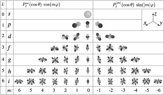

So, let's think about what you're seeing when you look at an image like this one:
Spherical harmonics
source: Зефр, CC0, via Wikimedia Commons
The $m=0$ orbitals, arranged in the vertical column in the middle of the table, are the ones without any variation in the $x$-$y$ plane, with all of the variation along the $z$-axis. The real $|m|=1$ orbitals are associated with the $x$-$z$ and $y$-$z$ planes. Each increase in $m$ adds another subdivision to the $x$-$y$ plane, while removing a subdivision from the $z$-direction. Once you get to $|m|=\ell$, along the diagonals of the pyramid, then all of the variation is in the $x$-$y$ plane.
But the $m$ in this figure isn't the $m$ corresponding to the projection of the orbital angular momentum, because in this figure the densities are already separated into real cosine and real sine terms. Those wavefunctions are complex. The projections in this figure are their real and imaginary components, which combine with opposite phases. Sorting out which kind of visualization you are seeing is tricky, because different authors and illustrators find different conventions "natural" and "obvious," and use the same quantum numbers to mean slightly different things.
For $|m|=\ell$, you also remove all but a single maximum in the radial probability density, and you recover Bohr-like orbits.
