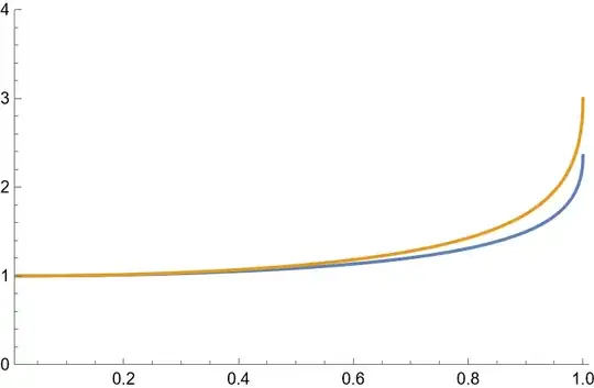

In the opposite limit $e\to 1$, one has $C_r \to 3\pi/4$ and $C_z \to 3$.

The following graph shows the dependence of these constants on the eccentricity. The blue curve is $C_r$ and the gold curve is $C_z$.

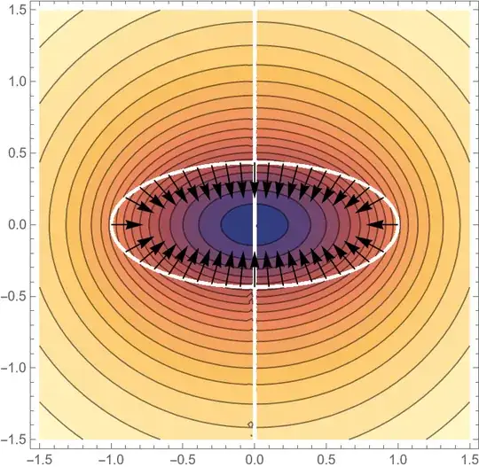

As a visualization of an oblate spheroid’s gravity, the following image shows the contour lines of the potential — both interior and exterior — and the vectors for surface gravity, for a spheroid with eccentricity 0.9:
The white ellipse is the surface of the spheroid. The vertical white line is an artifact of not taking sufficient care when evaluating the potential on the $z$-axis.
Note that the force vectors are orthogonal to the equipotential surfaces, not to the surface of the spheroid. And note that in general they don't point toward the center of the spheroid.

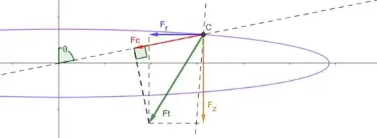

The resultant total force $F_t$ is easily found using Pythagoras:
$$F_t = \sqrt{F_r^2 +F_z^2}.$$

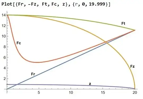

Below is a plot of $F_r, \ F_z, \ F_t, \ F_c$ and $z$, from $r=0$ to $r=a$.
This plot is colour coded the same as the force vectors in the diagram above it. The magenta curve ($z$) is the elliptical profile of the oblate at $e = 0.99$. The gold curve ($F_z$) is the vertical component of the surface force and drops off to zero going towards the equator. The blue curve is the horizontal component ($F_r$) that points at the vertical $z$-axis. This component steadily increases going from the centre to the equator. The green curve ($F_t$) is the resultant for $F_r$ and $F_z$ and only drops off by about $20\%$ going from the centre out to the equator. The red curve ($F_c$) is the component of the total surface force that points directly at the centre and after an initial drop off starts to increase linearly going outwards.

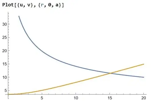

If we naively assumed the central force was proportional to $\dfrac{G\ M \ m}{R^2}$ (where $R = \sqrt{r^2+z^2}$), then the required balancing centrifugal force would require a velocity of $u = \sqrt{\dfrac{G \ M \ m}{R}}$, while using the central pointing force $F_c$ derived above, the required velocity to produce the required balancing centrifugal force is given by $v = \sqrt{ F_c \ \ R}$ and these two velocity curve profiles are plotted below for comparison:
The classic assumption (blue) for stable orbital velocities, drops off with increasing distance from the centre, while the exact solution presented here, shows the required balancing velocities increase with increasing distance from the centre. Note that this fact cannot eliminate the requirement for invoking dark matter to account for the flat orbital velocity curves that are seen in galaxies, because the flat curves extend far beyond the visible radius of the galaxy (sometimes by orders of magnitude) and these equation only apply to the visible radius. Beyond the visible radius these equations would expect the rotation velocities to drop off with increasing distance from the visible matter of the galaxy if there is no dark matter.
