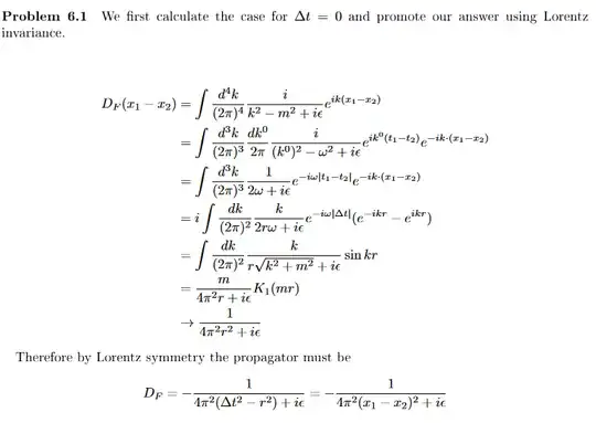

My other question (I will be happy to move this to separate post if inappropriate) involves an apparently different derivation of the above, some of the steps of which I would appreciate being explained, or hinted at. For completeness, I want to derive the dependence on $K_{1}$, not just state it and take the limit:
Question 2: Specifically, I don't quite understand how the integral over $d k^{0}$ is being performed from the second the third line (have we transformed to a frame in which $\vec{k} = 0$?). The question mentions use of Schwinger parameters, which I think is perhaps treated in the linked posts above, but I'm not sure as they don't seem to be in the form stated in Schwartz.
I'm a bit unsure on the last couple of steps but I assume that I'll find some integral trig representation of $K_{1}$ somewhere that'll match up.
Question 3: Why can we just invoke Lorentz symmetry here to reinstate the rest of the coordinate dependence? Is this just because we transformed frames to ease calculation?
