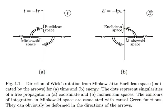

ps: This material by Yuri Makeenko (page 8) gives a figure to show poles and the directions of Wick rotation. enter image description here

In your case, $A=4(im^2+\epsilon)$ and $B=ix^2/4$, so $\mathrm{Re}A=4\epsilon>0$ and $\mathrm{Re}B=0$ which does not satisfy the convergent condition. Therefore, to guarantee the convergence of the integral, we should treat $B=ix^2/4$ as the limit $B=\lim_{\epsilon'\rightarrow0+}i(x^2-i\epsilon')/4$. Thus we have $$\Delta(x)=\lim_{\epsilon,\epsilon'\rightarrow0+}\frac{-1}{16\pi^2}\int_0^\infty d\beta \exp\left[-\frac{i\beta (x^2-i\epsilon')}{4}-\frac{i(m^2-i\epsilon)}{\beta}\right]\\ =\lim_{\epsilon,\epsilon'\rightarrow0+}\frac{-1}{4\pi^2}\sqrt{\frac{m^2-i\epsilon}{x^2-i\epsilon'}}K_1\left(\sqrt{-(m^2-i\epsilon)(x^2-i\epsilon')}\right)\\ =\lim_{\epsilon'\rightarrow0+}\frac{-m}{4\pi^2\sqrt{x^2-i\epsilon'}}K_1\left(m\sqrt{-(x^2-i\epsilon')}\right)$$ As a result, the singularity of the propagator is at $x^2-i\epsilon=t^2-\mathbf{x}^2-i\epsilon=0$, i.e. $t=\pm(|\mathbf{x}|+i\epsilon)$.
Actually, the convergent condition of the integral restricts the analytic regime of $\Delta(x)$: $$0<\mathrm{Re}(ix^2)=\mathrm{Re}(it^2)=-\mathrm{Im}(t^2)$$ i.e. $$(2n-1)\pi\le\arg(t^2)=2\arg(t)\le 2n\pi\\ (n-\frac{1}{2})\pi\le\arg(t)\le n\pi$$ Therefore, $\Delta(x)$ only can be analytically continued to the second and the forth quadrants in the complex plane of $t$. In conclusion, the wick rotation in $t$ plane should be clockwise.
