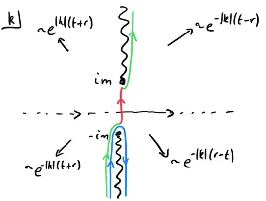

Now the trick to do this integral relies on the complex plane once again. Instead of poles, the square roots give two branch cuts: Complex plane in k I've indicated the high energy behavior of the integrand in each quadrant of the complex plane. This is determined by the imaginary part of $p$ (called $k$ in the diagram), as well as which side of the branch cuts we're on. The original contour is the dashed black line. As you can see, the contour cannot be deformed to the upper left quadrant, where it always diverges ($r$ and $t$ are always positive). We can always deform it however to go along the bottom branch cut.
On the right, where we can deform our contour depends on the sign of $\tau^2$. For $\tau^2<0$, we can only deform to the bottom right quadrant, where the final result is the discontinuity along the bottom cut (blue contour). This discontinuity turns out to be purely imaginary, and therefore the integral vanishes for $t<r$, as well it should. This gives us the factor of $\theta(t-r)$.
For $\tau^2$ now, we can only deform to the upper right quadrant. The integrals along the cuts (green) are again purely imaginary and give no contribution. However, we now have a bridge (red) that crosses between the two cuts. This is our final answer. We parametrize $p = \text{i}\mu$, and we get, $$G(t,r)=-\frac{\theta(t-r)}{4\pi^2r}\int_{-m}^m\text{d}\mu\,\mu\cos\left(t\sqrt{m^2-\mu^2}\right)\frac{\text{e}^{\mu r}}{\sqrt{m^2-\mu^2}},$$ which we may also parametrize by $\mu=m\cos\theta$, $$G(t,r)==-\frac{\theta(t-r)m}{4\pi^2r}\int_0^\pi\text{d}\theta\cos\theta\cos\left(m t \sin\theta\right)\text{e}^{mr\cos\theta}.$$
I am not smart enough to reduce this to the form involving the Bessel $J$, but this integral can be handled numerically. I do see that for any input $t\neq r$, my result agrees with, $$G(t,r) = -\frac{\theta(t-r)m}{4\pi}\frac{J_1(m\tau)}{\tau}.$$ This slightly differs from the answer you quoted. I may be wrong by a factor of 2, but I am fairly sure my factor of $m$ is correct, since your quoted equation cannot be right by dimensional analysis. The delta term is likely there to cancel a divergence that you would otherwise get from the $J_1$ term when $\tau=0$. The integral I found converges there, whereas $J_1(m\tau)/\tau$ does not. Again, someone smarter than me can probably finish this computation.
