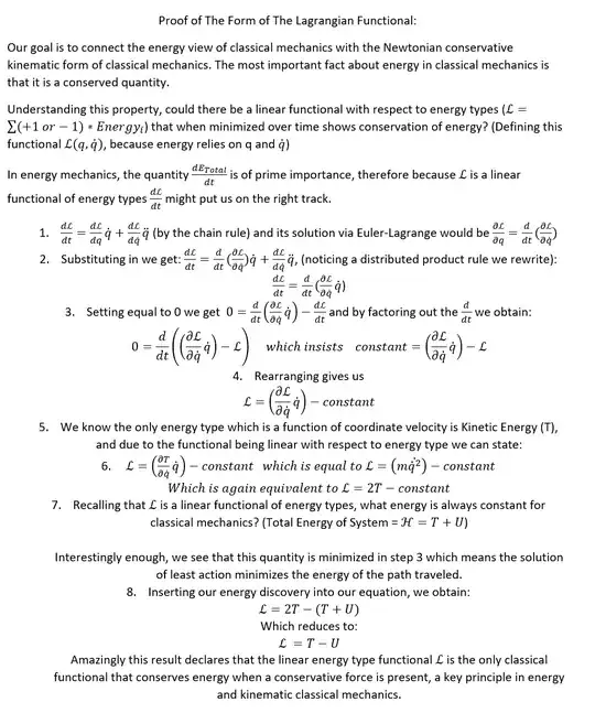

Proof 1: I have one of my own which is less intensive:enter image description here
As a footnote to that proof: Because what we found as the total energy of the system is conserved, the equation in line 3 has new a new meaning: at every point along the real trajectory aka the solution of the Euler-Lagrange equation, the particle will move in the direction which keeps its total energy constant. In other words, the Lagrangian path is the path which minimizes the change of total energy from point to point (WHICH SHOULD BE ZERO).
