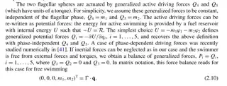

Let us assume that the system is driven by some conservative forces $\bf Q^{(c)}$ such that $$Q_k^{(c)}=-\frac{\partial U}{\partial q_k}$$ where $U$ is the internal energy.
In the paper below, the system has no inertial forces ($Re=0$) and once they have determined $\bf q$, $\partial r_{j}/\partial q_j(\mathbf{q})$ and $F_j(\mathbf{r})$ they go straight onto solving the following force balance $$Q_k^{(c)}=Q_k^{(nc)}.$$ Why?

usumdelphini
  • 1,813
The paper's argument is that low Reynolds number means that |inertial forces| $\ll$ |viscous forces|, i.e. that the forces $\sum_i {\bf F}_i=m{\bf a}\simeq{\bf 0}$ approximately balance. Equivalently, in Lagrange equations, this amounts to neglecting the kinetic term $T$, so that the generalized forces $\sum_i {\bf Q}_i\simeq{\bf 0} $ approximately balance.
