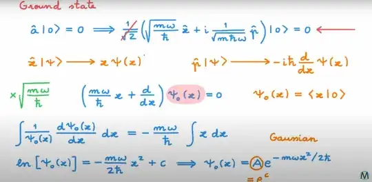

According to this video (at the timestamp), the professor writes down the derivation of the ground state of the 1D quantum harmonic oscillator.
Here is the screenshot from the slides of where she does it:
Now that is well and good. However, I am wondering what if we tried to derivate the ground state wavefunction for the interacting vacuum $| \Omega \rangle$ in the same way. Could we?

And maybe we could do
$$\hat{a}| \Omega \rangle = 0$$
Just like in the screenshot and video to attain the ground state wavefunction, but this should not work since
$$\hat{a}| \Omega \rangle \neq 0$$
