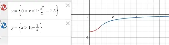

So now the proton radius. You may have heard that the proton has a "charge radius." It's worth emphasizing that this is not the size of the proton's wavefunction. Typically, the size of a proton's wavefunction, or it's $\Delta_x$ in the formula $\Delta_x\Delta_p\geq \hbar/2$, is much bigger than "the proton radius." Instead, the proton radius is, in the sense of the previous derivation, the size of the "relative part" of the wavefunction of the quarks. This is all very handwavy, but in a sense, think of a wavefunction that initially has four particles: two up quarks, a down quark, and the electron, and for the quarks, we add this to the hamiltonian: $$ H=\frac{p_{u1}^2}{2m_u}+\frac{p_{u2}^2}{2m_u}+\frac{p_{d}^2}{2m_d}+V_{QCD}(u1,u2,d) $$ Remember how the electromagnetic interaction ensures that we have a wavefunction in terms of the relative positions of the proton and the electron, which localizes them to be within about a Bohr radius of each other. Like that, the QCD potential ensures that the quarks are within a proton radius of eachother (much smaller than a Bohr radius). So how do we deal with the effect this has on the Hydrogen wavefunction? An approximation we make is to say that instead of a "point charge-like" potential: $$ V_0=\frac{1}{4\pi\varepsilon_0}\frac{e^2}{|x_d|} $$ We use a potential that would arise from the proton being a uniformly charged sphere, which looks like this (but scaled to the right proton radius and total charge): enter image description here
The difference between the two potentials we treat using perturbation theory. Seeing as you're in a quantum mechanics course, you're soon to learn how perturbation theory works, and you might even have this as a homework question.
