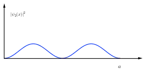

$$ V(x) = \left( \begin{array}{cc} 0 \ , & \text{for} \ 0 \leq x \leq a \\ \infty \ , & \text{elsewhere} \end{array} \right) $$ Which gives rise to the following normalized solution $$ \psi_n(x) = \sqrt{\frac{2}{a}} \sin\left( \frac{\pi n}{a}x \right) $$ My problem is what the nodes in the square function represents. If I draw $|\Psi_2(x,0)|^2=|\psi_2(x)|^2$ I obtain a graph similar to the one below.
What is the physical explanation that finding the particle around a small region around $a/2$ is close to zero? Or why is it so much less likely to find it near $a/2$ than $a/4$? E.g. why is $$ P(a/2 -\varepsilon \leq X \leq a/2+\varepsilon) = \int_{a/2-\varepsilon}^{a/2+\varepsilon} \left| \psi_2(x) \right|^2 \,\mathrm{d}x \sim 0 $$ for small $\varepsilon$

Recall that the functions $\psi_n$ are energy eigenstates; these states are very special. A generic quantum state of the system is simply some continuous, square-integrable function $\psi$ on $[0,a]$ that vanishes at the endpoints of the interval; within these requirements, it can have any shape. Moreover, any such function can be written as a linear combination of the energy eigenfunctions $\psi_n$.
The precise functional form of the wavefunction is determined by the way in which the state of the system is prepared. In particular, a generic state of the system need not have any nodes.

Physically, what you have is a standing wave. Even though it's this bizarre seeming probability wave, it still shares properties with waves on a string or in the water. It must always be zero at the boundaries, so at x=0 and x=a it is pinned at zero. In the middle you have a wave function. It will rarely be found at a/2 for n=2 because of the physical restraints you have placed on it. For n=1, it will almost always be found at a/2, and for n=3 it will almost never be found at a/3.
Physically, an infinite square well is not really possible. We can approximate it, but it is not physically possible. The properties of the waves you are studying give rise to many of the physical properties we see in the quantum world, such as quantized energy levels in atoms. Don't get too caught up in the probability distribution piece, because ladder operators will be much more of a mind trip than that. :-)
