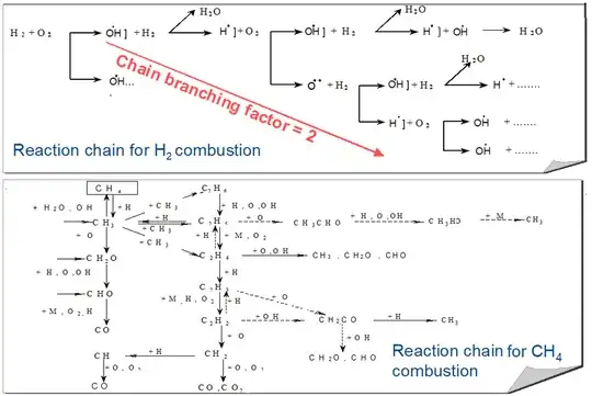

Rusting of iron is an oxidation reaction, but not combustion. Although the reaction's equation looks the same as the equations for combustion (e.g., of hydrogen and oxygen mixture, $2\text{H}_2+\text{O}_2\to2\text{H}_2\text{O}$), the reaction mechanism is different: combustion reactions are chain reactions, where intermediate reaction products (e.g., various radicals of hydrogen, oxygen and water molecules in the example of $2\text{H}_2+\text{O}_2\to2\text{H}_2\text{O}$) serve to trigger more and more reactions, resulting in positive feedback / avalanche process, which is the reason for the rapidity of combustion and explosions in comparison to iron oxidation, which can be essentially treated as encounter between two molecules.
The figure for a chain reaction below comes from here
