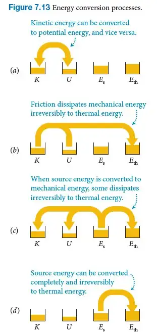

In a textbook “Principles & Practice of Physics” by Eric Mazur, I came across two things, which make me ask this question.
First, on the picture below the author lists possible energy conversion processes.
By $E_s$ the author means so-called “source energy”, here what he means:
Broadly speaking, there are four kinds of source energy: chemical energy; nuclear energy; solar energy delivered by radia tion from the Sun; and stored solar energy in the form of wind and hydroelectric energy.
Second, when the concept of entropy is discussed, the author relates entropy change of an ideal gas with change of its thermal energy distribution and change particles’ position.
Looking at the picture I was wonder whether there are other possible energy transformations (e.g. thermal energy into chemical energy) and how one can explain them in terms of entropy.
