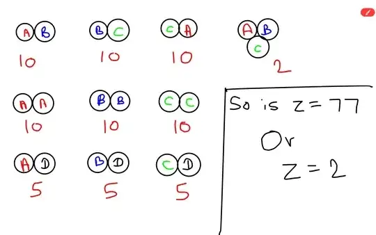

Then would Z include every possible collision like:
Collision between two different molecules like a and b or band c or a and c.
Collision between two same molecule like between a and a etc.
Collision between all three reactants at same time.
And most importantly does $Z$ include collision between reactants and products like a collide with d?
Or does $Z$ only include all collision (effective or non effective) of all reactants a,b and c at same time?

Yes, normally Z would imply collision of all the three reactants in the same time, since thee molecules have to be close to each other in order for chemical transformation to occur. Consequently, the law of mass action would involve product of the densities of all the three reagents: $$K\sim [a][b][c].$$
However, if there is an intermediate product, then we can talk about pairwise collisions only, e.g. $$ a + b + c = ab + c = d.$$ But in this case we are talking about two subsequent chemical reactions.
Note that the reactions with many intermediate products are quite common - e.g., the difference between combustion and conventional oxidation reaction is the former involves formation of many intermediate products, which makes it very fast. See Can we call rusting of iron a combustion reaction?
Roger V.
  • 68,984
Such reactions are not usually elementary reactions, but there is typically some reaction schema, requiring particular time order of collisions.
Also, if an elementary reaction has just a single product, the reaction rate depends on collisions with other molecules to pass the reaction energy while honoring momentum conservation.
E.g. $\require{mhchem} \ce{2 H(g) <=> H2^{*}(g) ->[collision]H2(g)}$
