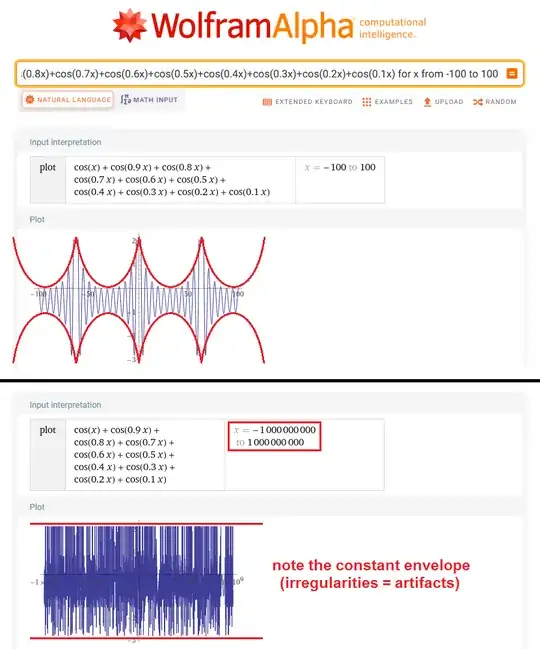

Here is a small "simulation" to further motivate the question and also demonstrate some of the gaps in understanding. Consider, for instance, a simple superposition of 10 cosine functions with different frequencies:
Sum of cosines
(Wolfram Alpha: 1st plot, 2nd plot)
If each cosine function is interpreted as the interference fringe pattern generated by a single frequency, it is easy to explain oscillating fringe contrast envelopes by a simple superposition. This pattern, however, extends to $\pm\infty$ without any decay in fringe contrast, i.e. the fringe visibility function does not have a compact support as in the experimental data shown above or, in fact, for any realistic case. So already the reproduction of such experimental data - i.e. oscillating fringe visibility functions with compact support - is by all means not a trivial problem and requires a continuum description w.r.t. frequencies and phases, Fourier theory etc.
Another "disturbing fact", to illustrate the whole problem from a different angle: Note that a superposition of two waves with different frequencies can actually never produce static interference fringes, as explained in this answer. Therefore, the mere fact that a superposition of waves with a sufficiently large number of frequencies suddenly leads to the emergence of visible fringes is actually quite astonishing! And the question

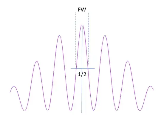

Then, from the correlation, it is also easy to calculate the coherence length. I assume that you mean the HMFW of the correlation function. We take the maximum of $C_{max}=C(\Delta x)$. Then we calculate one half of it. And finally we look for the $\Delta x$ such that $C(\Delta x)=C_{max}/2$. Then $2 \Delta x$ is the HMFW of the correlation function, one of the possible definitions of coherence length.
This picture graphically shows how to calculate the FWHM
If there are bumps, it is possible that $C(\Delta x)$ equals $C_{max}/2$ in multiple points. Then, you should take the first (minimum) $\Delta x$. Why? Because this definition ensures that, within the coherence length, the correlation remains more than $C_{max}/2$.
Of course, you can define the coherence length in other ways. For example, as the width of the envelope. Or the variance, considering $C(\Delta x)$ as a distribution. Every time you say that the coherence length is, say, 4 cm, you should always say if you mean the HMFW or something else. The definition of "coherence length" depends on you, not on the multi- or single-mode laser.
