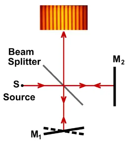

I've built a simple Michelson interferometer from two mirrors and a beam splitter according to the following schematic:
Image source
My setup differs from the one in the publication in that mirror M1 can be both translated along the optical axis as well as tilted. This is in order to adjust the optical path length difference between both interferometer arms, i.e.
  1. from the beam splitter to mirror M1 and back,
  2. from the beam splitter to mirror M2 and back.
Merely tilting M1 would allow for only a very limited path length difference, so I used a sliding mount to increase the adjustment range.
Yesterday, I tested the setup using the expanded and collimated beam from a regular green laser pointer, starting off from nearly identical lengths of the interferometer arms. The tilt of mirror M1 was adjusted to get a nice fringe pattern with the right distance between fringes to be comfortably observed by eye on a nearby screen. The fringes have very nice contrast going to zero in the minima.

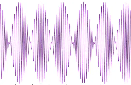

Arranging the terms: $$ I(x,y) = 2 |\phi_1|^2 + 2 |\phi_1|^2 \cos\left[k_1(x-y)\right] + 2 |\phi_2|^2 + 2 |\phi_2|^2 \cos\left[k_2(x-y)\right] \tag{4} $$ The two modes just superpose, as expected. But now we remember that $k_1$ and $k_2$ are quite close, since the modes have a small frequency difference. In order to exploit this fact, we use the prosthapheresis formulas: $$ I(x,y) = |\phi_0|^2 + \frac{|\phi_0|^2}{2} \cos\frac{(k_1+k_2)(x-y)}{2} \cos\frac{(k_1-k_2)(x-y)}{2} \\\ = I_0 + \frac{I_0}{2} \cos\frac{(k_1+k_2)(x-y)}{2} \cos\frac{(k_1-k_2)(x-y)}{2} \tag{5} $$ where we further assumed $\phi_1=\phi_2=\phi_0/2$.
Moving the mirrors, we change $x-y$. The effect is an oscillation, at a spatial frequency $k_1+k_2$: what you spatially see as the fringes. But there is also a modulation, at much smaller frequency $k_1-k_2$. This gives the decay of the fringes at much smaller spatial frequency, of the order of mm.
Graph of I(x-y)

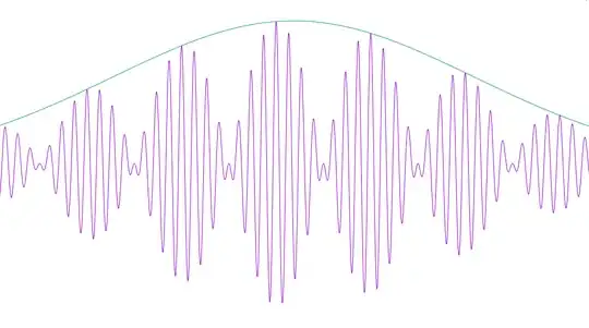

These fringes never disappear, they oscillate like a cos function. But this was obtained assuming that each of the two modes have an infinite correlation length. More realistically, the correlation of each mode is finite. Just as an example, let us assume a Gaussian with a given variance $\sigma^2$. Then the oscillations will be damped for increasing path length distances: $$ I(x,y) = I_0 + \frac{I_0}{2} \cos\frac{(k_1+k_2)(x-y)}{2} \cos\frac{(k_1-k_2)(x-y)}{2} \exp \frac{(x-y)^2}{2\sigma^2} \tag{6} $$
This is an example of the result of Eq. 6 The green line, the envelope, decays at the correlation length of a single mode.
However, as discussed above, this decay length, $\sigma$, can be very, very, very long!
In general, the correlation of a single mode is not necessarily Gaussian, but typically bell-shaped. And it is likely that, in a multimode emission, the various modes, taken separately, have a similar correlation.
