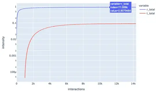

Since I wrote the quoted paragraph, I guess I can quantify. Let's imagine a transparent piece of glass, where incident light is reflected with amplitude $r$, absorbed with amplitude $a$, and transmitted with amplitude $t=1-a-r$. If we put two of these pieces parallel to one another, the transmission falls to $t^2$. Actually, it's a little more than $t^2$, because some of the internally-reflected light makes it through after bouncing around in the gap between the two windows.
Now suppose that we have a thousand of these transmitting layers, each with $r=\frac{1}{100}$. The direct transmission $t^{1000}=(0.99)^{1000}$ is only about forty parts per million. I wrote a little tool to keep track of the light sloshing around in the interior layers, and found that the total reflectivity of this stack is about 91%:
Plot of reflected and transmitted intensity
Here the transmission is zero until the light has gone through a thousand transmit/reflect processes, because the light must cross all thousand surfaces to reach the other side. By that point, at the 1000th interaction, about 75% of the incident light has already leaked out the incident side as a reflection. A big pile of high-quality transmitting windows is a terrible transmitting window.
You can also see that a very small absorption coefficient, with all of the back-and-forth-ing that takes place in such a system, will have a big effect on the total transmitted power. Compare to discussions of blackbody radiation which demonstrate a startlingly dark small aperture into a big box, only to reveal that the inside of the box is lined with reflective foil. This is a demo that isn't effective on a computer video, because "startlingly dark" on a computer screen is just "off."
