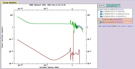

Just to put some numbers on scattering vs absorption of neutrons in water, I've pulled data from ENDF.

For oxygen:
neutron scattering on 16O
It looks even worse - even at thermal energies the absorption cross section is 4 orders of magnitude smaller than elastic scattering, and that only gets worse at higher energies towards the original fission neutron energy.
