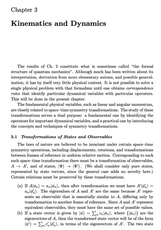

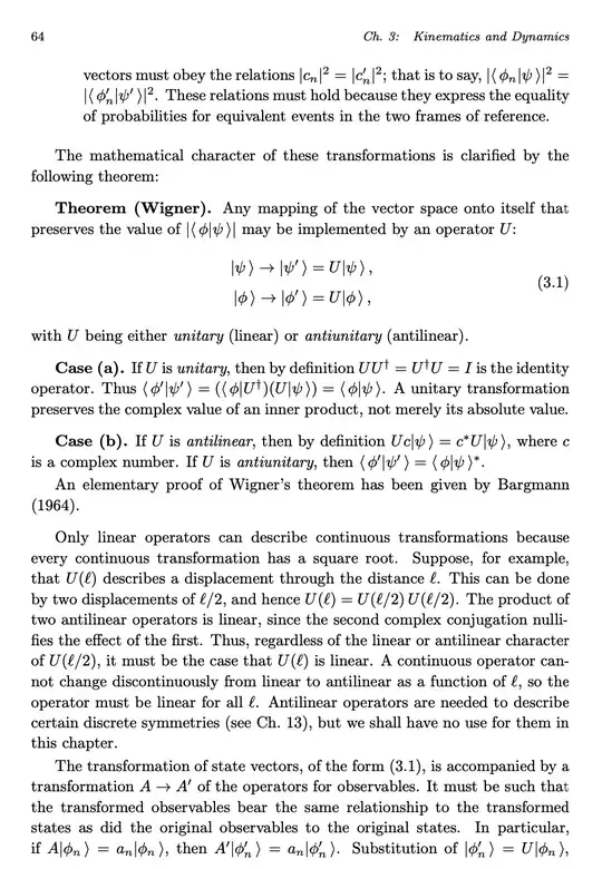

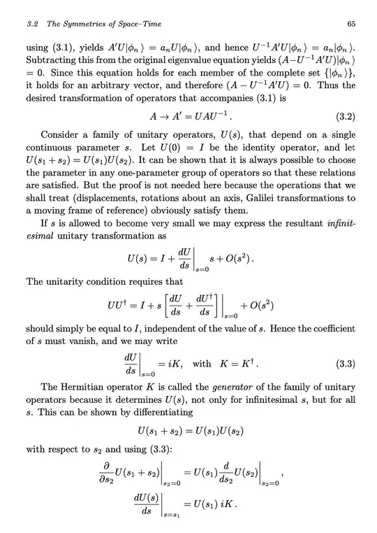

I am trying to follow the development in Ballentine's Quantum Mechanics: A Modern Development but am struggling a lot. Please excuse my attaching of a picture of the development, but my question quite literally has to do with not being able to parse things so I fear it's a crucial inclusion. I also think that, though this question references a specific book, the crux of this question is widely applicable: what does it mean to say that the laws of physics are invariant under certain transformations, and how does that relate to corresponding transformations of the quantum mechanical Hilbert space.
My question:
With respect to page 63, bullet point (a): why must the eigenvalue $a_n$ NOT change in the transformed system? If I have $Q|x\rangle = x|x\rangle$ and I transform the system via a displacement (active point of view, but I suppose in the passive point of view I think of things as looking at the same system from a different frame of reference) then I want the $|x'\rangle$ corresponding to $|x\rangle$ to obey $Q|x'\rangle = x'|x'\rangle$, don't I? I think I have a fundamental misunderstanding of what "invariant under certain space-time symmetry operations" ought to mean.
Edit: I have found this answer which, unfortunately, is not entirely satisfactory. In particular, Ballentine seems to say that the properties (1) and (2) given are what we must demand because they are fundamental to how spacetime transformations "work", and then goes on to show in his equation (3.2) that this implies the transformation rule for operators $A' = UAU^\dagger$ for some unitary or anti-unitary operator $U$. Thus presupposing that transformations of operators ought to be of this form is begging the question.
Edit 2: I have added more pictures as context for the discussion. As I explain in more detail below, I think the crux of things here is my misunderstanding of what the "priming" operation which Ballentine does in defining the physical/experimental requirements (a) and (b) means. Feel free to ignore the extended discussion beforehand. The last paragraph is what matters.
Note this is very long, and it represents my understanding of Ballentine's entire Chapter 3.1; again, skip to the next/last paragraph for the question proper. We begin by noting the physical assumption/experimental fact that the measurements we do on any system must be/are invariant under certain transformations (in the nonrelativistic limit, these will be the Galilean transformations; although how we actually think about doing those transformations is unclear to me as per the last paragraph to follow), with invariance here meaning that these transformations (at this point represented by some unclear priming (') operation) are such that (a) and (b) on p.63 are respected. We then invoke Wigner's theorem, which says that any transformation obeying (b) can be written as a unitary or antiunitary transformation. We further note (again, a physical fact) that the transformations under which our universe displays invariance are all continuous, so that the argument given by Ballentine means that in our universe, all of the transformations under which (a) and (b) are respected are unitary. Now the preceding development, applied to our requirement (a), gives us the transformation rule (3.2) for operators! After equation (3.2), we then develop Stone's theorem formally (in the sense of not rigorously); every continuous family of unitary operators $U(s)$ (with respect to one parameter) is generated by some self-adjoint operator $K$ -- this is equation (3.4). That is, every transformation of a system which demands invariance in the sense of (a) and (b) are generated by some $K$. In Chapter 3.2, we'll make precise exactly what this set of transformations is. Here, we've just established that we can write them as in (3.4).
The only thing I struggle to make rigorous is what exactly is meant by "transformation" above. I think the crux of this is what Ballentine means by priming (') in (a) and (b). Are we saying that we imagine (actively) transforming both the state and our coordinate system somewhere else in space/time (e.g. we shift our state and our coordinate system by some displacement, or we rotate our state and our coordinate system by some angle) and use that the laws of physics (i.e. any measurement we could make of any observable $A$) is identical in that case too? Is there any way to make this all precise?

This really isn't anything specific to quantum mechanics, this is a general statement about how passive coordinate transformations work in physics:
Consider a classical observable $f$ that yields some value $f(s)$ for some state $s$ (this is an abstract point in phase space, not some tuple of coordinates). In one choice of phase space coordinates $(x,p)$, we find that $f(s) = f(x,p) = x$, i.e. it is just position. Now, in the coordinate system with $x' = x + a$ for some shift constant $a$ (i.e. the first system translated by $a$), we then have that $f(s) = x = x' - a$, so $f(x',p') = x' - a$, since changing coordinates on phase space cannot change the value that $f$ has on the state $s$.
The eigenvalue of the operators $A$ and $A'$ in your excerpt plays the role of the $f(s)$, and the $A$ and $A'$ are the analogue of the different coordinate expressions $f(x,p)$ and $f(x',p')$, while the $\lvert\phi\rangle$ and $\lvert\phi'\rangle$ are the analogues of the different coordinate expressions $(x,p)$ and $(x',p')$ of a state (i.e. classically a point in phase space).
That is, when $A$ as in your example is a position operator, $A$ represents "measure distance with respect to a certain origin O" and $A'$ still represents "measure distance with respect to O as the origin" - the transformation isn't changing what the observable means, it's just changing your expression for the observable as a concrete operator because you changed how you describe the point O in your maths, so $A$ and $A'$ need to have the same eigenvalues - "the distance with respect to O" is a notion that doesn't change if you translate your coordinate system around or rotate it.

The quantum answer, after invoking Wigner, goes like this: consider a unitary transformation $U$. Applying it to any pure state yields $|\psi^\prime\rangle=U|\psi\rangle$. Applying it to any operator yields $A^\prime=U A U^\dagger$. Then $$A^\prime |\psi^\prime\rangle=U A U^\dagger U |\psi\rangle=U \left(A|\psi\rangle\right).$$ This means that, if you want to know the action of $A$ on $|\psi\rangle$ in the new coordinates, you just transform the result you got in the old coordinates according to $U$. And, if you take expectation values, you find $$\langle\psi^\prime |A^\prime|\psi^\prime\rangle=\langle \psi|A|\psi\rangle.$$ Keeping these relationships in mind helps me understand all of active and passive transformations.
Let's use a mundane example that you are trying to make a long piece of paper by taping together two pieces of paper, then you change which units you want to use for the measurement. The piece of paper is like $|\psi\rangle$, the action you do on the paper by taping two pieces together is like $A$, and changing units is like $U$. Initially your paper is 28 cm long, you apply the taping action ("add 28 cm"), now your paper is 56 cm long. In the transformed coordinates, initially your paper is 11 inches, you apply the taping action ("add 11 inches"), now your paper is 22 inches long. And the relationship that holds it all together is that you can apply the transformation to the final result and it all makes sense: transform 56 cm to inches and you find 22 inches.
To specifically answer your questions:
(a) If eigenvalues changed, it would make a difference if we applied the transformation first to $A$ and $|\psi\rangle$ and then did our action $A^\prime |\psi^\prime\rangle$, versus if we applied the transformation after the action as $U(A|\psi\rangle)$. With the piece-of-paper example, it shouldn't matter if we change our units of measurement before or after we tape two together two pieces of paper! We tend to take this freedom for granted in most physical theories (I can talk about how far away you are from me without specifying where the earth is in the solar system), and so Wigner's theorem codifies the only ways in which we can build this freedom into our physical theories.
(b) Yes, exactly. The density operator is an operator, and operators transform as $\rho\to U\rho U^\dagger$. In particular, it is a Hermitian operator with positive eigenvalues and we have just seen that the eigenvalues of an operator should be unchanged by our set of transformations. This works nicely because it just generalizes the notion of the transformations of states: $$U\rho U^\dagger=U\left(\sum_m \omega_m |\psi_m\rangle\langle\psi_m|\right)U^\dagger=\sum_m \omega_m U|\psi_m\rangle\langle\psi_m|U^\dagger=\sum_m \omega_m |\psi_m^\prime\rangle\langle\psi_m^\prime|.$$ You'll find all of the nice relationships you want with $A^\prime \rho^\prime=U (A\rho)U^\dagger$, $\mathrm{Tr}(A^\prime \rho^\prime)=\mathrm{Tr}(A \rho)$, etc.
Now perhaps the confusion arises solely from notation. Ballentine uses $x$ and $|x\rangle$ to denote the eigenstate and eigenvalue of operator $X$. The prime, or the $a$ label in $x^\prime=x+a$, tells us about a new coordinate system. But maybe it would be better to label the ket and operator by $a$ but not the eigenvalue: $X_a$ has eigenstates $|x\rangle_a$ with eigenvalues $x$. Then you don't have to worry about the eigenvalue changing. Now, $X_a$ and $|x\rangle_a$ are the operator and eigenstate in coordinate system labelled by $a$, always satisfying $X_a|x\rangle_a=x |x\rangle_a$ for all $a$.
Or we just explicitly say that the eigenvalue is not labelled by the coordinate system, only the operators and states are labelled by the coordinate system, because the transformations only exist on operators and states (think $U xU^\dagger=x$ for scalar $x$). This must be the case, because most transformations involve more than one degree of freedom! Sure, it is easy to do $x\to x+a$, but how should some eigenvalue change if your transformation is "move left two and up three" or "rotate clockwise by $\pi/3$?" None of these transformations tells you what to do to some scalar eigenvalue, so the eigenvalues must be left unchanged by the transformations.

The best way to do this is the simplest one and the one which clarifies what the book says. I don't understand what the author says by similar operator as most of the others have assumed a translation operation (the easiest one) but it is easier to use a generalised version. so like @quantum mechanics says the expectation value should be some for both the operators but what he missed out is the relation between the eigenvalue and the expectation value. say , $A|\Psi_N\rangle=C_N|\Psi_N\rangle$ multiplying with the bra of $|\Psi_N\rangle$ you get $\langle \Psi_N|A|\Psi_N\rangle=\langle\Psi_N|c_N|\Psi_N\rangle$
$\langle A\rangle=c_N$. (this is because for pure states you can assume normalised states)
Now as the books says after a Unitary transformation you should get $$\Psi'_N=U\Psi_N $$and $$ A=UA'U^\dagger$$ Usually we take the opposite and replace the A with A' but since Unitary operators and their conjugate's product is Identity, you can show either fomulation is equivalent.
For the new state for say, some new eigenvalue $c_N'$ $$A'|\Psi'_N \rangle=c_n'|\Psi_N' \rangle$$ Following a similar process as the first one by multiplying the bra of $|\Psi_N'\rangle$ you get ; $$\langle\Psi_N'|A'|\Psi_N'\rangle=\langle\Psi_N'|c_N'|\Psi_N'\rangle$$ Applying the Unitary transformation
$$\langle\Psi_N|U^{\dagger}A'U|\Psi_N\rangle=c'_N\langle\Psi_N|U^{\dagger}U|\Psi_N\rangle$$ But as $\Psi_N$ is normalised you should get; $$\langle \Psi_N|A|\Psi_N\rangle=c'_N$$ But we already know that $\langle A \rangle=c_N$ Hence, $$c_N=c'_N$$ and similar operators have same eigenvalues
