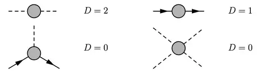

Now suppose we have the pseudoscalar Yukawa Lagrangian: $$ L = \frac{1}{2}\partial_\mu\phi\partial^\mu\phi-\frac{1}{2}m^2\phi^2+\bar\psi(i\not\partial-m)\psi-g\gamma^5\phi\bar\psi\psi. $$ We can find its superficial degree of divergence as $D= 4-\frac{3}{2}N_f-N_s$. From this manual (p.80), we can find all divergent amplitudes as follows: enter image description here We do have other divergent graphs with odd scalar external lines. However, the author ignored them, and claimed they are potentially divergent diagrams that actually vanish. I wonder is there a straightforward way to see they vanish?
And as a consequence, does that imply we will need to add $\phi^4$ term in the Lagrangian and its counterterm $-i\delta_4$ to make the theory normalizable, but don't need to add $\phi^3$ term and its counterterm $-i\delta_3$ to the entire Lagrangian? Does this have anything to do with the fact that this Lagrangian is invariant under the parity transformation?

  1. $\gamma_5$ likes to be sandwiched between $\bar{\psi}$ and $\psi$. So, the interaction term should read $-g \phi \bar{\psi} \gamma_5 \psi$.
  2. $\bar{\psi} \gamma_5 \psi$ is a pseudoscalar, consequently also $\phi$ has to be a pseudoscalar.
  3. As a consequence, an interaction term like $\phi^3$ is forbidden by parity invariance.
  4. In order to formulate a consistent renormalizable theory (in 4 space-time dimensions) ALL possible terms up to (operator) dimension 4 invariant under space time symmetries and possibly also other symmetries have to be included. As the interaction term $\phi^4$ is even under parity, it must be included in the Lagrangian you are starting with.

Yes, one must for consistency as a minimum include all possible renormalizable terms that are not excluded by symmetry, cf. my related Phys.SE answer here. Pseudoscalar Yukawa theory has a $\mathbb{Z}_2$ parity symmetry that excludes odd $\phi^n$ terms. However the even $\phi^n$ terms with $n=2,4$ must be included.
