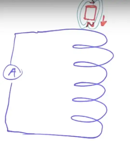

If I have a permanent magnet falling through a coil, North pole first, what is the direction of the induced current and how do I figure it out by myself using Lenz's Law and Flemming's hand rules

Try to make it more obvious which way your coil is winded by 'hiding' the part of the coil which goes behind the wires.

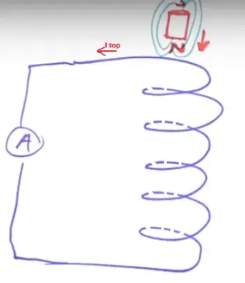

I'll assume that it's wounded clockwise when looking from the top, in which case the induced current will be going from the top of your coil to your ampmeter (right to left on the top wire of your drawing) when the magnet is entering the coil:
current at the beginning
When the magnet is leaving the coil at the bottom, the current will flow in the other direction. And when the magnet is completely inside the coil, there is no current (as the current induced from the N pole crossing the turns gets cancelled by the current induced from the S pole crossing the turns above). See these questions and answers for more details:
