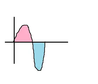

If you have drop a bar magnet through a coil so that it goes all the way through I was told the graph of emf induced in the coil vs time looks something like this:
(emf induced is on y axis, time is on x axis)
The area of the pink part and the blue part are equal (sorry that they don't look equal in my diagram)
I understand why the blue part looks more stretched than the pink part -- the magnet is accelerating. What I don't understand is the direction of the blue part -- it is opposite (negative) to the pink part (positive).
Why does the s-pole induce an emf in the opposite direction to the one induced by the n-pole when a bar magnet falls through a coil? The field lines at the s-pole and n-pole are pointing in the same direction, so the induced emf should continue increasing in the pink part (rather than turning and going below zero) because the field from the n-pole is complemented by the field from the s-pole which is cutting the flux in the same direction as the one from the n-pole.
Please explain in layman terms.
Thanks!
Note: Layman terms means you can use stuff from high school physics (left/right hand rules, lenz's law, etc.), but not e.g. calculus.

One of Maxwell's equations is $$ \nabla \times \vec{E} = - \frac{d\vec{B}}{dt} \, .$$ Consider an imaginary disk whose normal vector is parallel to the axis of the coil and which is inside the coil. If you integrate this equation over the area of that disk you get $^{[a]}$ $$\mathcal{E} = - \dot{\Phi}$$ where $\Phi$ is the flux threading the disk and $\mathcal{E}$ is the EMF drop around the loop. This is called Faraday's law.
So, for each imaginary disk inside your coil we get some EMF as the flux through that disk changes in time.
Now think about the bar magnet's descent. Suppose we drop it starting way above the entrance to the coil. It's far away, so there's no flux and no EMF. As it descends and gets close to the entrance of the coil, some of the magnetic field from the magnet threads the top few imaginary disks of the coil. The time changing flux induces some EMF. This is the initial rise in the red part of the diagram. As the magnet continues to fall, and enters the coil, more of its magnetic field is threading imaginary disks in the coil, so as it moves the time rate of change of total flux increases, so the EMF goes up. Note that the field lines above and below the bar magnet point in the same direction.
At some point, the bar reaches the middle of the coil. At this point, the amount of flux added to the top half of the coil by a small motion of the magnet is equal to the amount of flux removed from the bottom half. Therefore, at this point the EMF is zero. This is the midopint of the diagram where the EMF crosses the horizontal axis. The falling part of the red section is just the approach to the mid section of the coil.
As the bar magnet exits the coil, more flux is leaving than is entering, so the EMF versus time in the blue section is just the opposite (except for the stretching which you already understand) of the red section.

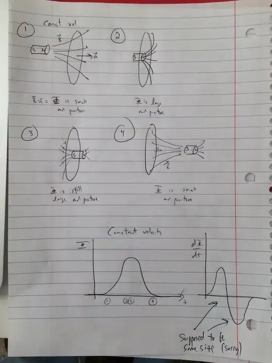

Here are some pictures to explain:
For the case of constant velocity:
The constant velocity case

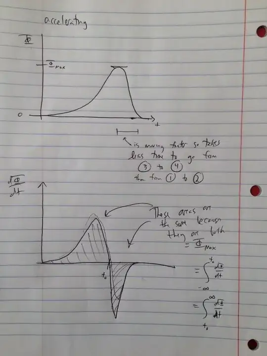

And for the case of accelerating (the case you are actually interested in):
And, one final note to sum it all up, the induced EMF is the coil is $\left(-\frac{d\Phi}{dt}\right)$. I chose my $\vec a$ (the area vector) pointing "to the right" which means that the positive sense of current is in the direction of the fingers when using the right hand rule with the thumb in direction of $\vec a$. Since the induced EMF is actually the negative of the values shown in the $\frac{d\Phi}{dt}$ drawings, the current flows in the opposite direction as the direction that the fingers on the right hand are pointing.

E.M.F(induced)= -(rate of change of magnetic flux).
Which implies that the direction of E.M.F depends upon the sign of the Rate of Change of magnetic flux.
When the magnet is moving into the coil, magnetic flux is increasing(Because magnetic feild(and thus flux) are greater nearer we get to the poles), while when it is coming out magnetic flux is decreasing.Therefore, when entering the loop, rate of change of magnetic flux is positive, and while coming out, it is negative.
Thus, EMF has two different signs.

I'm not sure if a complete description in 'layman terms' is possible, but I'll have a go at an answer without advanced mathematics.
We will need to use some equations: in particular, Faraday's law that the EMF is given by the rate of change of the magnetic flux through the coil: $$\mathcal{E} = -\frac{\partial \Phi_B}{\partial t}$$ This means that the integral of $\mathcal{E}$ over time effectively gives the change in magnetic flux: $$\int \mathcal{E} dt = -\Delta\Phi_B$$ The area of the two parts must then be equal, as the magnetic flux built up from zero when the magnet enters is the same as the magnetic flux that goes to zero when the magnet leaves. This is something that cannot be understood without calculus.
As for the direction of the EMF, (and we don't need to use calculus here, to address your main question), notice the statement of Lenz's law is that:
If an induced current flows, its direction is always such that it will oppose the change which produced it.
The direction of current flow in the loop is clearly given by the direction of the EMF. Now, as you point out, the field lines are pointing the same way at both the North and South poles (we will assume that the north pole goes through first). But whereas the North pole enters the coil (when it is nearer to the coil), the South pole leaves the coil after the North pole crosses it, and this makes all the difference. So, in the same direction, the strength of the magnetic field/flux through the coil is increasing when the north pole is coming in, but decreasing when the south pole is leaving.
In the former case, there is one direction of current to decrease the increasing flux, in the latter case, there is another direction of current to increase the decreasing flux. Thus, the directions of the EMFs between the two cases are opposite.

According to Lenz's Law, an EMF generated by changing magnetic flux in a coil creates an electric current that flows in the direction which generates an induced magnetic field opposed to the changing flux that produces it.
So, for example, as the north pole of a magnet passes through a coil, current travels counter-clockwise in the coil (looking in the direction of the magnet's passage). This creates an induced EMF with polarity that acts against the increasing flux of the magnet.
By Lenz's law, the induced magnetic field always acts so as to try to keep the magnetic flux inside the coil constant. As the north pole of the magnet enters farther into the coil, the induced EMF tries to COUNTER the increasing flux inside the coil created by the passage of the magnet. It gets stronger, with polarity opposite to the passing magnet.
When the north pole exits, and when the south pole of the magnet enters the coil, the induced EMF begins to AUGMENT the passing magnet's EMF so as to try to keep the decreasing flux constant. In order to augment the decreasing flux in the coil, the induced EMF must have the same polarity as the passing magnet.
The change in polarity explains why the curve is above the x axis until the magnet begins to exit the coil, when it shifts to below the x axis.
