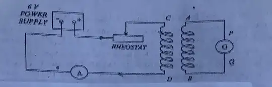

I understand the Lenz Law is such that it tells us that the induced current must be in a direction that makes the end of the solenoid facing the magnet behave as a North Pole to repel the magnet’s North Pole thus its motion is opposed. Since Lenz’s law is a consequence of the principle of the conservation of energy. A magnet that is pushed into the coil is repelled. What I can’t seem to understand is the direction of the induced current. I’ve been told that the direction is clockwise, not counter-clockwise. A teacher told me to use the Right Hand Grip Rule, but the way how I see it when I do it, I am seeing it in the counterclockwise direction. The question is: looking from the AC end, what is the direction of the induced current? Can someone please explain to me how the induced current is going in the clockwise direction?

Here we have electromagnetic induction. Variable currents induce magnetic fields in loops, according to the Right-Hand Grip Rule. Since the current given by the power supply is going from C to D, the magnetic field generated by the left circuit goes from the D to C direction. This is, looking from the coil of the C end, the magnetic field inside the solenoid is coming to you. The vector is DC orientated, meaning the N pole is in C. Now, when this generated magnetic field is studied in our right loop/circuit, its magnetic field lines are going from A to B because magnetic lines are closed and go back to the initial point. This is, looking from the A-coil you see an entering vector arrow. So, as you said, this magnetic field is perturbing the AB solenoid and due to the Conservation of Energy, the second solenoid is preparing another magnetic field, called induced magnetic field, to counter the effects of the first magnetic field. So, how do you think this solenoid is going to do this? Well, through the flow of a second current which is the induced current. This current does not have another alternative than going from A to B, since it is the only way it can create a magnetic field to oppose the change in this second solenoid. So, looking from the coil of the AC end the induced current (i) in the second solenoid is COUNTERCLOCKWISE. The main mistake in these cases is related to the position of the hand. The thumb indicates the direction of the magnetic field when the other fingers adjust to the current direction, but it depends if the loop of the solenoid is made clockwise or counterclockwise, so be careful. Here you have your case, the current going from the North Pole to the South Pole: enter image description here
