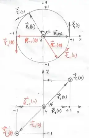

It is sometimes worth drawing a diagram(s) to visualise the situation with both undergoing anticlockwise rotations about the z-axis.
The first to note is that $\dot z = 0$ and nor $c$.
Hopefully from the diagrams and doing the appropriate sums you can show that $\omega_{\rm z}$ is the same for both motions.

We could write $\vec r_2= - \vec r_1$.
Particle 1 is rotating anticlockwise around z axis in a plane parallel with $(x,y)$ at $z=1$.
Particle 2 is rotating anticlockwise around z axis in the same plane but is diametrically opossed to particle 1.
Both particles 1 and 2 have the same angular speed $\vec \omega= c*\vec e_3$.
(The angular speed is perpendicular to the plane of rotation when the particle rotates with constant speed)

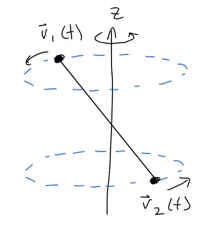

Before getting into the question, it needs to be said that it makes no sense to assign a single angular velocity to two particles unless more is specified (what are their masses? are they part of a rigid body? etc.). For this reason, we slightly modify the original scenario and assume the two particles are connected a massless rigid rod. This combines them into a 1D rigid object in which it makes sense to talk about the rotation of that object.
The ambiguity of the angular velocity vector persists, and I will explain exactly why it is there, and why it is not really a problem. The problem doesn't even pertain to just the angular velocity vector, but angular displacement as well, so for this reason I attached the following links to other posts of mine where I explain (one of various possible ways of talking about) angular displacements:
Explaining the Ambiguity
Consider the two particles $$ \vec{r}_{1}(t) = (\cos ct, \sin ct, 1) \quad\text{ and }\quad \vec{r}_{2}(t) = (-\cos ct, -\sin ct, -1) $$ connected by a massless rigid rod. The motion $\vec{r}_{1}(0) = (1, 0, 1)\rightarrow\vec{r}_{1}(t)$ and $\vec{r}_{2}(0) = (-1, 0, -1)\rightarrow\vec{r}_{2}(t)$ can be given by the rotation matrix $$ R(t) = \begin{pmatrix} \cos ct & -\sin ct & 0 \\ \sin ct & \cos ct & 0 \\ 0 & 0 & 1 \end{pmatrix}, $$ but it can equally as well be given by $$ S(t) = \underbrace{ \begin{pmatrix} \cos ct & -\sin ct & 0 \\ \sin ct & \cos ct & 0 \\ 0 & 0 & 1 \end{pmatrix} }_{R(t)} \underbrace{ \begin{pmatrix} \tfrac{\cos(ct/\sqrt{2})+1}{2} & \tfrac{\sin(ct/\sqrt{2})}{\sqrt{2}} & \tfrac{-\cos(ct/\sqrt{2})+1}{2} \\ -\tfrac{\sin(ct/\sqrt{2})}{\sqrt{2}} & \cos(ct/\sqrt{2}) & \tfrac{\sin(ct/\sqrt{2})}{\sqrt{2}} \\ \tfrac{-\cos(ct/\sqrt{2})+1}{2} & -\tfrac{\sin(ct/\sqrt{2})}{\sqrt{2}} & \tfrac{\cos(ct/\sqrt{2})+1}{2} \end{pmatrix} }_{X(t)}. $$ Here $R(t)$ is a rotation about the $z$-axis. The matrix $S(t)$, on the other hand, represents a rotation $X(t)$ about the $(1, 0, 1)$-axis followed by a rotation $R(t)$ about the $z$-axis.
Here we immediately see the issue: because the two particles and the rod are always along a line through the origin, there is freedom in how we can rotate about that line without making any difference to the actual particles. This is the reason for the ambiguity in my original post.
If one calculates the corresponding angular velocity vectors (see above links for how to do this) we obtain $$ \vec{\omega}_{R}(t) = (0, 0, c) $$ and \begin{align} \vec{\omega}_{S}(t) &= \vec{\omega}_{R}(t) + R(t)\vec{\omega}_{X}(t) \\[1.0ex] &= (0, 0, c) + (-\tfrac{c}{2}\cos ct, -\tfrac{c}{2}\sin ct, -\tfrac{c}{2}) \\[1.0ex] &= (-\tfrac{c}{2}\cos ct, -\tfrac{c}{2}\sin ct, \tfrac{c}{2}). \end{align} More generally, we have freedom to add any vector that is parallel along the line along which the particles line up, which is any scalar multiple of $(\cos ct, \sin ct, 1)$.
As soon as we introduce another particle whose position is linearly independent from the existing ones, the ambiguity and the degree of freedom in both the rotation matrix $R(t)$ and the angular velocity $\vec{\omega}(t)$ are lost!
Any rigid body with $\ge 2$ linearly independent points will have a uniquely determined rotation matrix $R(t)\in\textrm{SO}(3)$ and angular velocity $\vec{\omega}(t)\in\mathbb{R}^{3}$ for all $t$. Thus, this is no issue for any 3D extended rigid body.
If we replaced our particles by extended spheres (whose points are distinguishable and can be tracked), we would have no ambiguity as to what $\vec{\omega}(t)$ would have been, because the different angular velocities would have produced different motions (in real life we could place a piece of tape to one of the spheres and $\vec{\omega}_{R}$ vs $\vec{\omega}_{S}$ would produce different traces of that tape).
