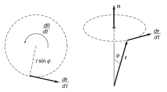

To clarify this further, consider the following figure which depicts the rotation in 3d space, and conforms to the example given in the question,
Rotation in 3d space in spherical coordinates
where the spherical-polar coordinates $\theta$ and $\phi$ are used as the azimuthal and polar angles, respectively and the zenith ($z$-axis) is taken to be parallel to $\hat{\mathbf{n}}$.
In the limit of infinitesimal change in time, $\Delta t \rightarrow 0$, $$ \Delta \mathbf{r} \approx r \, \sin \phi \, \Delta \theta ~, $$ and thus, $$ \left| \frac{d \mathbf{r}}{d t} \right| = r \sin \phi \frac{d \theta}{d t} ~. $$
One clearly observes that both the magnitude and the direction of $\frac{d \mathbf{r}}{d t}$ (which is perpendicular to the plane defined by the particle position $\mathbf{r}$ and the rotation axis $\hat{\mathbf{n}}$) are given correctly by the cross product
$$ \frac{d \mathbf{r}}{d t} = \hat{\mathbf{n}} \times \mathbf{r} \frac{d \theta}{d t} ~. $$
Since $\frac{d \mathbf{r}}{d t} \equiv \mathbf{v}$ and $\hat{\mathbf{n}} \frac{d \theta}{d t} \equiv \vec{\omega}$, one obtains
$$ \mathbf{v} = \frac{d \mathbf{r}}{d t} = \boldsymbol{\omega} \times \mathbf{r} ~. $$
Therefore, the instantaneous axis of rotation $\hat{\mathbf{n}}(t)$ and the instantaneous angular velocity $\vec{\omega}(t)$ are indeed parallel.
Finally, as shown by Gary Godfrey in a comment, one can obtain the correct relation for the angular velocity $\boldsymbol{\omega}$ in terms of the velocity $\mathbf{v}$ and position $\mathbf{r}$ as
\begin{align} \mathbf{r} \times \mathbf{v} &= \mathbf{r} \times ( \boldsymbol{\omega} \times \mathbf{r} ) \stackrel{\text{BAC-CAB}}{=} \boldsymbol{\omega} \, (\mathbf{r} \cdot \mathbf{r} ) - \mathbf{r} \, (\mathbf{r} \cdot \boldsymbol{\omega}) \\ \Rightarrow \boldsymbol{\omega} &= \frac {(\mathbf{r} \times \mathbf{v}) + \mathbf{r} \, (\mathbf{r} \cdot \boldsymbol{\omega})}{r^2} ~. \end{align}
This answer is based on Kleppner, D., and R. Kolenkow. “An introduction to mechanics”, (2ed, 2014), pp. 294–295. The figure is taken from the same source.
