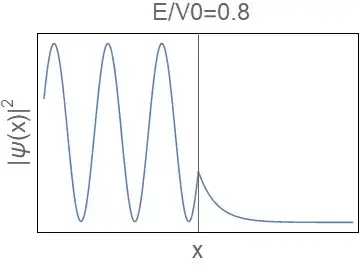

The (generalized) eigenstate corresponding to a particle incident on the barrier from the left with energy $E=\hbar^2k^2/2m<V_0$ takes the form $$\psi_k(x) = \begin{cases} e^{ikx} + r_k e^{-ikx} & x < 0 \\ t_k e^{-q_k x} & x \geq 0\end{cases}$$ where $$\matrix{q_k \equiv \sqrt{\frac{2m(V_0 - E)}{\hbar^2}} \\ r_k \equiv \frac{2iq_k}{k-iq_k}\\ t_k \equiv 1+r_k = \frac{k+iq_k}{k-iq_k}}$$
Based on this picture, we might imagine (correctly) that there is a nonzero probability of measuring a particle with $E<V_0$ within the potential step. However, we need to be a bit careful - this is a non-normalizable (and hence unphysical) state, after all, so if we want to understand what happens dynamically, we should construct a real, physical state. Such states take the form of wavepackets, which may be written

  • The components of the wavepacket with energy $E<V_0$ are all reflected eventually; however, they penetrate into the barrier by an exponentially small distance ($\psi_k\sim e^{-x/\ell_k}$, where $\ell_k=1/q_k$) and are delayed by a correspondingly small amount of time before being reflected.
In particular, if all of the components of the wavepacket have energy less than $V_0$, then the wavepacket will be perfectly reflected - however, it will be distorted because the different components penetrate different depths into the step before being reflected, and during the reflection there will be a nonzero (but exponentially small) chance of measuring the particle to be physically located at some $x>0$.
We can now turn our attention to your main question of what happens when we have a potential barrier of width $L$, and a wavepacket whose components all have energy less than $V_0$. From a qualitative and dynamic perspective, everything proceeds exactly as it did with the potential step. As the wavepacket approaches the barrier, its components penetrate into the classically forbidden region by an exponentially small distance before being reflected. However, because the barrier has a finite width $L$, a fraction $\sim e^{-L/\ell_k}\equiv e^{-q_k L}$ of the components of the wavepacket will make it all the way through the barrier and escape to the other side$^\dagger$.
