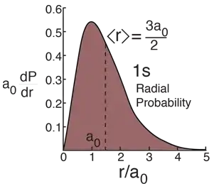

Assuming you are talking about the Hydrogen Ground State Radius, both your calculations and what Wikipedia stated are truth. Its average value is indeed $\frac{3}{2} a_0$ as you've calculated. The most probable value however is $a_0$ (see image below). I hope this clears up.
The Expectation Value for Radius
