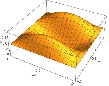

It won't be easy to plot such a function. If both particles are constrained to move in one dimension, the total wavefunction will be a function of two variables, which would be easier to plot. E.g. for a ground-state electron in an infinite square potential well and a twice-excited positron in the same well we'll have the following function:
