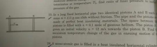

Suppose in a gaseous container we have two movable pistons , consider its moving with speeds u and v and between them is the monoatomic gas , now at later time its temperature might increase , when we write first law of thermodynamics between two stages why dont we consider energy change due to change in momentum of gas particles inside also in the linear momentum equation of whole system(gas + piston)? My Sir said usually the olympiad problems like this one the change in momentum is very negligible and neglected, does there a proof of this? Like this pf problem too:
(in case not readable: In a long fixed horizontal pipe two identical pistons $A$ and $B$ each mass $m=415 \mathrm{~g}$ can slide without friction. The pipe and the pistons are made of perfect heat insulating materials. The space between the pistons is filled with $n=0.1$ mole of gaseous helium. The piston $\mathrm{A}$ is given an initial velocity $u=12 \mathrm{~m} / \mathrm{s}$ towards the piston B. Find maximum temperature change of the gas in ensuing motion of pistons.)

Since we're free to assume any inertial frame regarding changes in temperature, let's assume for convenience that we're moving to the right at speed $u/2$, half the initial speed of the left piston. Now the problem is symmetric, with both pistons moving inward at the same speed. (The gas is now moving to the left at speed $u/2$, but this doesn't matter because we're going to focus on the gas temperature; as noted above, this is defined to be independent of the gas speed.)
Because the speeds are far less than the speed of sound in the gas, the pressure is approximately the same everywhere in the gas; this pressure decelerates the pistons to a stop, which occurs for both pistons at approximately the same time because of symmetry. At this moment, the pistons have zero kinetic energy in our frame, and this is the point where the gas achieves its highest temperature.
