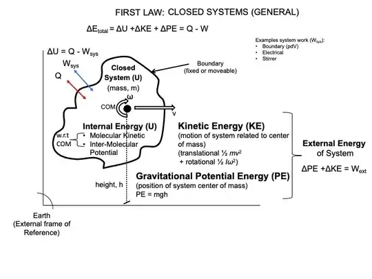

$\Delta U$ in the first law equation applies to the internal energy of the system, that is, the KE and PE at the molecular level. The mechanical energy of the system, which I like to call the "external energy of the system" because it depends on a frame of reference external to the system, is the KE and PE of system as a whole. Both the internal and mechanical energy of the system are included in the general form of the first law, as already pointed out.
The diagram below is my attempt to help illustrate the difference between internal energy and mechanical energy.
Hope it helps.
