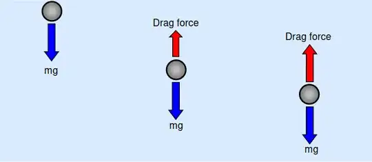

Mathematically, the movement of a drop can be described as $$ \frac{d\mathbf{r}}{dt}=\mathbf{v},\\ m\frac{d\mathbf{v}}{dt}=m\mathbf{g} + \mathbf{F}_{drag}, $$ (for simplicity I neglect the bouyancy.) The drag force is directed against the drop velocity and can be modeled as $$\mathbf{F}_{drag}=-m\gamma\mathbf{v}.$$ Choosing our $y$-axis along the vertical direction and assuming that the initial drop velocity is zero, we have: $$ m\frac{d v_y}{dt}=-mg-m\gamma v_y\rightarrow \frac{d v_y}{dt}=-g-\gamma v_y $$ The stationary velocity can be obtained readily by setting the right-hand side of this equation to zero: $$ v_0=-\frac{g}{\gamma}. $$ The above differential equation can be also easily solved with usual methods as $$v_y(t)=\frac{g}{\gamma}(e^{-\gamma t}-1).$$ This equation describes a drop that starts with initial velocity zero, accelerates towards the earth, and eventually approach velocity $v_0$. enter image description here
(the image is taken from this link)
The same phenomenon is often studied as a laboratory excercise in physics programs, where small balls are dropped in a viscous liquid, such as glycerol: due to high viscosity of the liquid, the ball quickly reaches its stationary velocity and then moves with a constant speed. E.g., see this video
