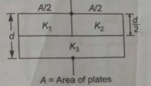

I am ripping my hairs trying to understand this answer, it is written that, for the following set up of two capacitor plates separated by distance $d$ and area $A$ with three dielectrics insert with constant $K_1,K_2$ and $K_3 $
The electric field is not necessarily normal at the boundary joining the dielectric substances $K_1$ and $K_2$. If it is so, precisely, what would be the directions at points along the surface? Would all of the electric field vectors attached to these points be tilted differently or have same tilt amount?

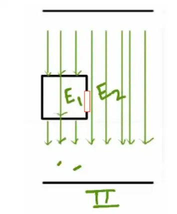

The boundary condition for the electric field states that the the tangential electric field on either side of the interface must be equal. This does not necessarily mean that it be normal to the interface. In the absence of free charges, the boundary condition for the normal part of the electric field is $$\epsilon_1E_{1\perp} = \epsilon_2E_{2\perp}$$
So what would happen in this case?

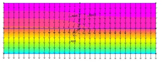

Let's consider two capacitors. They each consist of two plate seperated by a distance $2d$. They are both filled with two dielectrics, each dielectric taking up half the space between the conducting plates along the entire width, so that the thickness of each dielectric is $d$.
Consider now that capacitor 1 has dielectrics with permittivity $\epsilon_3$ and $\epsilon_1$ for the bottom and top dielectric respectivily. Capacitor 2 has dielectrics with permittivity $\epsilon_3$ and $\epsilon_2$ for the bottom and top dielectric respectivily.
For each, what will the voltage at the interface between the dielectrics be, if we set the top plate to a voltage V, and the bottom plate to 0V? Due to symmetry, the field lines are pointed straight down for both (ignoring fringing effects). Since the boundary condition for the perpendicular part of the electric field states that the electric flux density must be equal at the top and bottom, the voltage at the dielectric interface will be equal to $V\frac{\epsilon_1}{\epsilon_1+\epsilon_3} $ for capacitor 1 and similar for capicitor 2.
This means that the voltage at the dielectric interface will higher for the capacitor with the higher permittivity for the top dielectric.
What then happens when the two plates of capacitors are connected and we get the geometry similar to the linked question? [2
Far from the interface between the two capacitors, the voltage levels will be $V\frac{\epsilon_1}{\epsilon_1+\epsilon_3} $ and $V\frac{\epsilon_2}{\epsilon_2+\epsilon_3} $. Close to the interface, there must be a transition region where the electric field points in the direction of decreasing voltage, towards the side of the capacitor that had the lower permittivity in the top region.
Quick simulation in femm of the described geometry: A complete picture is of course given by solving Poisson's equation for electrostatics with the appropriate boundary conditions.

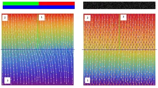

To illustrate nice answer by Cyrus, we simulate the capacitor with three dielectric plate with using finite element method implemented in Mathematica 12.3. In Figure 1 are shown lines of electric field for two variants of compound with relative dielectric constant in three regions: $K_1=2,K_2=1,K_3=3$ (left picture), $K_1=2,K_2=3,K_3=1$ (right picture). Figure 1
Note, that lines of electric field are bended from upper plate with higher dielectric constant to upper plate with lower dielectric constant.
