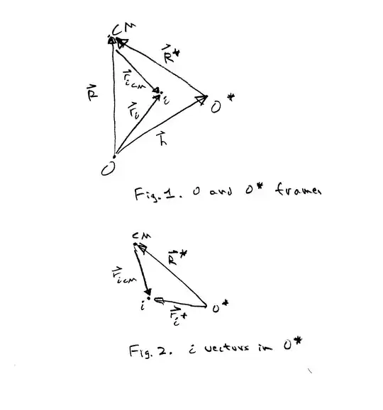

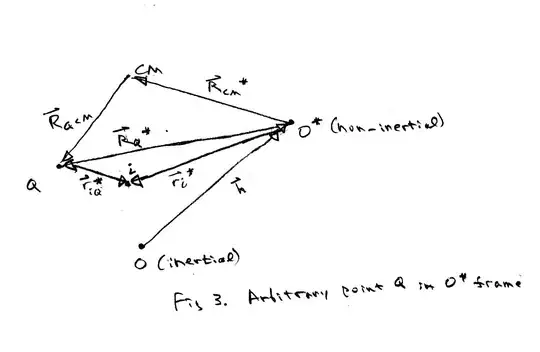

Consider a system of particles, not necessarily a rigid body. See Figures 1 and 2.
Figures 1 and 2

Consider a system of $k$ particles from the perspectives of both an inertial and a non-inertial frame of reference with respective origins at O and O*. O is stationary and O* is in acceleration with respect to O and the Cartesian axes for O* rotate with respect to those of O. CM denotes the position of the center of mass of the particles. As derived in physics mechanics textbooks, for a single particle in the system of particles [Symon] $(1) \enspace m{d^{*2} \vec r^{\, *} \over dt^2} = m( {d^{2}\vec r \over dt^2 }- \vec \omega \times (\vec \omega \times \vec r^{\,*} )- 2\vec \omega \times {d^*\vec r^{\,*}\over dt}- {d \vec\omega \over dt}\times \vec r^{\,*} - {d^2\vec h \over dt^2 })$

$(10)\enspace \vec r_i^* = \vec R^* + \vec r_{iCM}$ where $\vec r_i^*$ is the location of particle $i$ in the O* frame with respect to O*, $\vec R^*$ is the location of the CM in the O* frame, and $\vec r_{iCM}$ is the location of particle $i$ with respect to the CM. Therefore,
$(11) ∑_{i=1}^{k}\enspace m_i\vec r_i^* = ∑_{i=1}^{k}m_i\vec R^* + ∑_{i=1}^{k}m_i\vec r_{iCM}$.
By the definition of the CM
$(12)\enspace ∑_{i=1}^{k} m_i \vec r_i = MR$ where $M= \sum_{i=1}^{k} m_i$ is the total mass.
Using Fig. 1,
$(13)\enspace MR = \sum_{i=1}^{k} m_i \vec r_i =\sum_{i=1}^{k} m_i (\vec R + \vec r_{iCM}) = MR + \sum_{i=1}^{k} m_i \vec r_{iCM}$, therefore
$(14)\enspace \sum_{i=1}^{k} m_i \vec r_{iCM} = 0$ and Eqn. (11) reduces to
