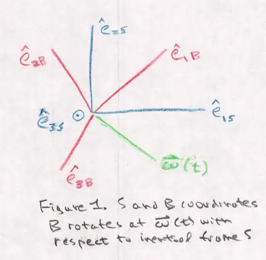

Consider two coordinate systems $S$ and $B$, assumed to have a common origin. $S$ is a fixed, inertial system and $B$ is a non-inertial system rotating at angular velocity $\vec \omega$ about the common origin with respect to $S$. See Figure 1. (For a rigid body, $S$ denotes the space frame and $B$ the body frame.)

We wish to evaluate any vector $\vec G$ from the perspective of both coordinate systems. As developed in Goldstein, we can consider the rotation of the $B$ frame as a passive rotation of the coordinate system, and $\vec G$ is the same vector in both coordinate systems. [Ref 1] Alternatively, we can consider an active rotation that rotates the vector. Equivalent results are obtained using either the passive or the active rotation approach, as subsequently discussed. Let the vector $(e_{1S}, e_{2S}, e_{3S})$ represent the axes unit vectors in the $S$ system and the vector $(e_{1B}, e_{2B}, e_{3B})$ the axes unit vectors in the $B$ system. We can describe $\vec G$ in terms of the $S$ and $B$ frame coordinates as ;$$(1) \vec G = \sum_{i=1}^{3} G_{iS} \hat e{i_S}$$ $$ (2) \vec G = \sum_{i=1}^{3} G_{iB} \hat e{i_B}$$ $G_{iS}$ and $G_{iB}$ are the magnitudes of the components of $\vec G$ along the $i^{th}$ axis in the $S$ and $B$ systems, respectively. The time derivatives of (1) and (2) with respect to the inertial frame are equal so: $$(3)\sum_{i=1}^{3} \dot G_{iS} \hat e{i_S} = \sum_{i=1}^{3} \dot G_{iB} \hat e{i_B} + \sum_{i=1}^{3} G_{iB} \dot {\hat e{i_B}}$$ [Ref 2] Note that in $B$ coordinates the time derivative has to account for the change in direction of the $(e_{1B}, e_{2B}, e_{3B})$ unit vectors in time. For consistency with the Goldstein nomenclature, Let ${d\vec G \over dt})_S$ be defined as $\sum_{i=1}^{3} \dot G_{iS} \hat e{i_S}$, and let ${d\vec G \over dt})_B$ be defined as $\sum_{i=1}^{3} \dot G_{iB} \hat e{i_B}$. [Ref 1] It can be shown that $\sum_{i=1}^{3} G_{iB} \dot {\hat e{i_B}} = \vec \omega(t) \times \vec G$. [Ref 2] Therefore, we can express (3) as $$(4) {d\vec G \over dt})_S = {d\vec G \over dt})_B + \vec \omega(t) \times \vec G$$ (4) is the relationship used in Goldstein and is the relationship addressed in your question. [Ref. 1] Since (4) is equivalent (3), we interpret ${d\vec G \over dt})_S$ to be in $S$ coordinates , and ${d\vec G \over dt})_B$ and $= \vec \omega(t) \times \vec G$ to both be in $B$ coordinates. However, as Goldstein points out, the vectors in (4) can be resolved along either the $S$ or $B$ axes, only after the differentiation has been carried out. [ Ref 1] This is addressed in subsequent examples.
Comparing (4) to (3), we can provide the following physical interpretations of each term in (4). The term on the left-hand side of (4) ${d\vec G \over dt})_S $ is the time derivative of $\vec G$ as seen by an observer fixed in the inertial $S$ frame. The first term on the right-hand side of (4), ${d\vec G \over dt})_B $, can be considered as the time derivative of $\vec G$ as seen by an observer rotating along with (fixed in) the $B$ system; or this term can be considered as the time derivative of $\vec G$ if $B$ is not rotating. The second term on the right-hand side of (4), $\vec \omega(t) \times \vec G$, accounts for the change in the $B$ system unit vector directions with time; that is, this second term is due to the rotation of the axes in the $B$ system.
