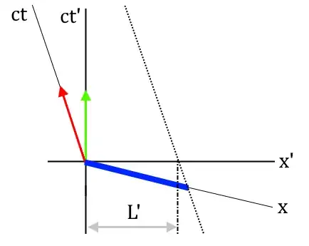

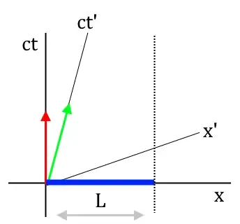

This may seem like a weird thing to require but to measure the length of a line, every point along that line has to exist at the same time. Let's say I want to measure the length of (a 1-dimensional) stick. I can give each of the points along that stick a pair of coordinates $(t,x)$. When I want to measure the length I will require by definition that each of the time coordinates is the same i.e. $t_1=t_2=t_3=\dots$ This is so obvious in your mind which is accustomed to Galilean relativity that you might forget it.
So let's draw a diagram. We have two frames: the primed and the unprimed frame. In the unprimed frame the length of the stick is $L$. Note that the stick traces out a rectangle in spacetime and to measure the length we took a slice at $t=0$ (the blue line).
Now we can transform to the primed frame using a Lorentz transformation. The blue line got transformed from the coordinates $(0,0), (0,L)$ to the coordinates $(0,0),(-\gamma\beta L,\gamma L)$. So you would think the new length of the stick is $L'=\gamma L$. In reality we have to consider a new time slice $t'=0$ and from the diagram we see that at $t'=0$ the length is smaller than $\gamma L$. By doing some calculations you will find that $L'=L/\gamma$.
Hint in case you want to do the calculations. You have to construct the dotted line in the primed coordinates. The line passes through the point $(-\gamma\beta L,\gamma L)$ and has slope $\Delta x'/\Delta t'=-v$ because the right end of the stick is travelling with $-v$ to the left. You can then read of the $x'$ coordinate of that line at $t'=0$.

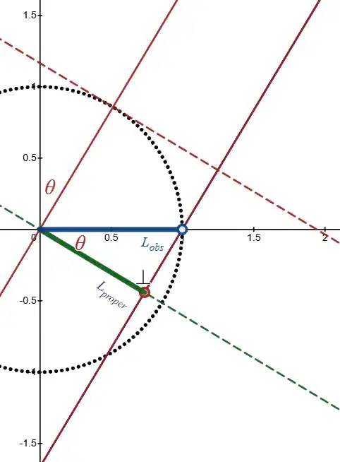

  • This should be familiar from Euclidean Geometry.
    robphy-EUC
    Given two parallel lines (in red).
    Note that "perpendicular" to the radial red line is defined as "tangent to the [unit] circle".
    (The red frame would label that "line" by the radius.. call the radius "$t'=1$"... so all points on that tangent have are assigned "$t'=1$".)
    Through the origin, draw the parallel to that tangent. Those points are assigned "$t'=0$".
    The "proper length" is the green segment along this parallel.
    We mark the "right angle" at the red point on the other red line.
    In the resulting right-triangle,
    the "observed length" ($\Delta x=L_{obs}$) is the (blue) "hypotenuse",
    the "proper length" ($\Delta x'=L_{proper}$ and $\Delta t'=0$ in the object frame) is the (green) "adjacent side".
    So, $$L_{observed}={HYP}=\displaystyle\frac{ADJ}{\mbox{"cosine"}}=\frac{L_{proper} }{\cos\theta} \geq L_{proper}$$ ...since $\cos\theta\leq 1$.
    This is why [observed] shadows on the ground [of an upright meterstick] can look very long: $L_{observed} \geq L_{proper}$.
    (Implicitly, I am taking the angle of the lines (with respect to the vertical) to be less than 45 degrees… since I will use these same lines as worldlines of the endpoints of an object in a position vs time graph.)

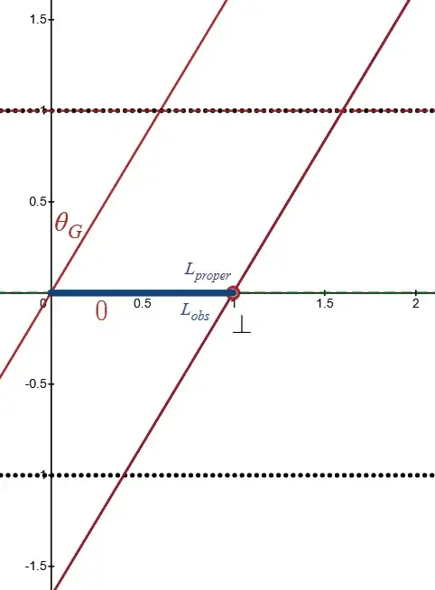

  • In Galilean relativity, on a "position-vs-time graph" with time running upward (a spacetime diagram), the "circle" is a horizontal line.
    All tangent lines will coincide... this is absolute simultaneity. No time dilation.
    Given the same two parallel lines (in red).
    By analogy with the above, we have a "degenerate right-triangle" so that $$L_{observed}={HYP}=\displaystyle\frac{ADJ}{\mbox{"cosine"}}=\frac{L_{proper} }{ 1} = L_{proper}.$$
    robphy-GAL
    Hence, no length contraction: $L_{observed} = L_{proper}$, as well as no time dilation, etc....

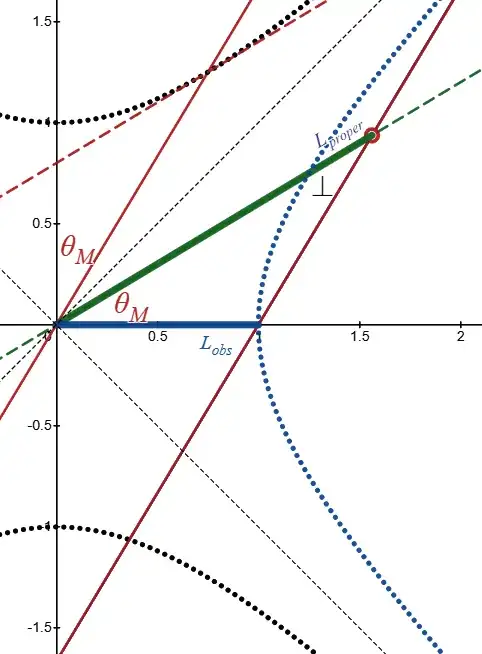

  • In Special relativity, on a "position-vs-time graph" with time running upward (a spacetime diagram), the "circle" is a hyperbola.
    (... following the same ideas in the Euclidean case above ...)

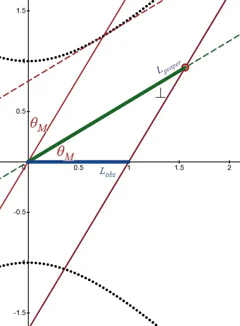

    By analogy, $$L_{observed}={HYP}=\displaystyle\frac{ADJ}{\mbox{"cosine"}}= \frac{L_{proper} }{ \cosh\theta_M } = \frac{L_{proper} }{ \gamma} \leq L_{proper}$$ ...since $\gamma=\cosh\theta\geq 1$.
    robphy-MIN
    Hence, "length contraction": $L_{observed} \leq L_{proper}$.
    (Yes, the hypotenuse (in blue) is shorter than the adjacent side (in green).)
    To see this, I'll draw in a "hyperbola of constant spacelike separation" (dotted blue)
    robphy-MIN-spacelike
