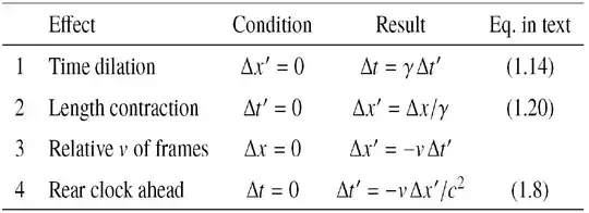

I was studying how the Lorentz transformations are derived, and found this table in Special Relativity for The Enthusiastic Beginner by David Morin. The primed frame $S'$ is taken to have a velocity solely along the positive x-direction of the unprimed $S$ frame.

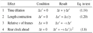

The table that specifies four conditions for deriving the Lorentz transformations. Taken from "Special Relativity for the Enthusiastic Beginner", by David Morin
I justified the four conditions to myself as follows:
  1. Time dilation can be stated as $\Delta t_{other frame} = \gamma \Delta t_{proper}$. The proper time is measured on a stationary clock in the concerned frame, so the condition $\Delta x' = 0$ and the result $\Delta t = \gamma \Delta t'$ made sense. This was because $\Delta x' = 0$ implied that the clock was stationary in the concerned frame, and $\Delta t'$ was the proper time.
The statements 3 and 4 could also be reconciled with a qualitative understanding of the rear clock ahead effect and that of relative velocity (thought I am a bit clunky with putting that into words here. If needed I will elaborate.) The conditions for length contraction and the results were confusing, however.
The way I understand it:
For length measurements in a particular frame, the measurements should be simultaneous in that particular frame.
So, with the condition $\Delta t' = 0$, the implication was that the length measurement was being taken in the primed frame. The basic idea of length contraction is $\Delta l_{other frame} = {\Delta l_{proper}}/{\gamma}$. So with the measurement being made in the primed frame, proper length would be the length measured in the primed frame, i.e. $\Delta x'$. Since the length observation in any other frame will be contracted, I arrived at $$\Delta x = \Delta x' / \gamma$$
This contradicts what the table says: $$\Delta x' = \Delta x / \gamma$$
So I was wondering what the fallacy in my logic was. I would really appreciate if someone worked through my argument and explained its mistake.

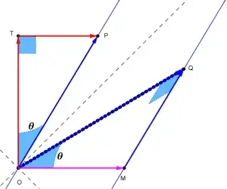

On a spacetime diagram drawn by person-B (GROUND),
we draw the blue parallel timelines (worldlines) of the front and back of train-A. Note
  • OQ (the proper length of train-A) and
  • OM (person-B's measured-length of train-A).
robphy-Morin-lengthContraction-1
Note that MQ (along the timeline of the front of train-A) is orthogonal to OQ (along the spaceline $t'=0$). So this is a Minkowski-right triangle $OQM$ with right-angle at $Q$, where $\theta$ is the equal to the rapidity ($v_{B,wrt A}=\tanh\theta$ and $\gamma=\cosh\theta$).
In this triangle, $OM$ is the hypotenuse (since it is opposite the right-angle) and $OQ$ is the adjacent-side.
So, $\displaystyle\gamma=\cosh\theta=\frac{ADJ}{HYP}=\frac{OQ}{OM}=\frac{L_{A,wrtA}}{L_{B,wrtA}}$ which can be written as
\begin{align} (HYP)&=\frac{(ADJ)}{\cosh\theta}\\ OM&=\frac{OQ}{\cosh\theta}=\frac{OQ}{\gamma}\qquad(1.19, 1.20) \end{align}

Morin-table-2.1.1
From the table, choose two events with $\Delta t'=0$ (so we don't need to worry about the so-far unknown coefficient-$B$): events $O$ and $Q$, which are simultaneous according to person-A (MOVING-TRAIN) $$\Delta t'_{OQ}=(t'_Q-t'_O)=0.$$

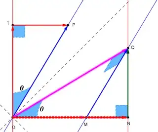

robphy-Morin-lengthContraction-2
consider a differently-sized train at rest according to person-B (GROUND, WITH REST-TRAIN) that person-A (MOVING-TRAIN) measures using events $O$ and $Q$.
Draw red parallels to B's timeline through event-O and through event-Q.
Note:
  • ON (the proper-length of this differently-sized train-B),
    where $N$ is the event on the front parallel that person-B says simultaneous with $O$.
  • OQ (person-A's measured-length of this differently-sized train-B).
Note that $ONQ$ is a Minkowski-right triangle, with right-angle at $N$ (so $OQ$ is the hypotenuse) and the same $\theta$ as before. Thus (following the ideas of above), \begin{align} (HYP)&=\frac{(ADJ)}{\cosh\theta}\\ OQ&=\frac{ON}{\cosh\theta}=\frac{ON}{\gamma} \end{align}
Compare the role of $OQ$ here and in (1.19) above.
Expressing these results in the $\Delta x$-notations (needed for 2.1.1)
from 1.3.3, \begin{align} (HYP)&=\frac{(ADJ)}{\cosh\theta}\\ OM&=\frac{OQ}{\cosh\theta}=\frac{OQ}{\gamma} \qquad(1.19,1.20)\\ \Delta x_{OM}&=\frac{\Delta x'_{OQ}}{\cosh\theta}=\frac{\Delta x'_{OQ}}{\gamma} \qquad(1.19,1.20 \mbox{ where $OQ$ is the proper-length of train-A}) \end{align}
from 2.1.1, \begin{align} (HYP)&=\frac{(ADJ)}{\cosh\theta}\\ OQ&=\frac{ON}{\cosh\theta}=\frac{ON}{\gamma}\\ \Delta x'_{OQ}&=\frac{\Delta x_{ON}}{\cosh\theta}=\frac{\Delta x_{ON}}{\gamma}=\frac{\Delta x_{OQ}}{\gamma} \qquad(1.20 \mbox{ where $OQ$ is the observed-length of train-B}) \end{align} so that $\Delta x_{OQ} = \gamma \Delta x'_{OQ}$, implying that coefficient-$A$ is equal to $\gamma$.
