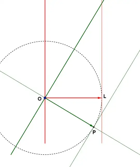

Part 1: An analogy in the Euclidean plane.
Consider two parallel lines---one through point O and the other 5 units away, when oriented vertically. These are the $\rm\bf\color{red}{red\ lines}$.
  • Note that $\vec{OL}$ is perpendicular to the red lines...
    and the important reason it is perpendicular is that
    $\vec{OL}$ is the radius of a circle and the distant parallel line is the tangent to the circle at $L$.
Euclidean analogue of Length Contraction-robphy
Now, let's rotate about point O and "tilt" the parallel lines to the $\rm\bf\color{green}{green\ lines}$.
To construct the distant parallel line to be 5 units away, we draw a circle centered at point O that goes through L and find the point (call it P) on the circle
whose tangent is parallel to the tilted line through O. Note that $\vec{OP}$ is perpendicular to the green lines, and it is the analogue of the "proper length".
Observe that "$\rm\bf\color{red}{Red}$" measures the "distance between the green lines" to be longer than $\vec{OL}$.
Observe that "$\rm\bf\color{green}{Green}$" measures the "distance between the red lines" to be longer than $\vec{OP}$.

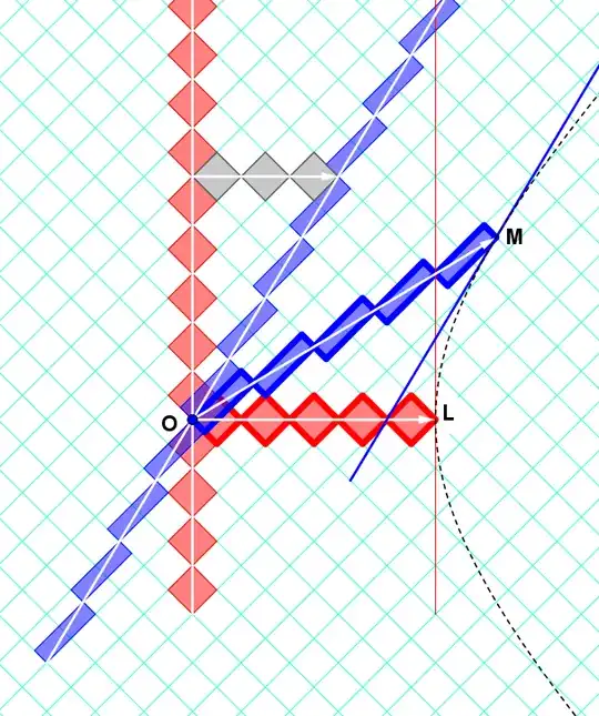

Part 2: Now, we'll do the Special Relativity case.
I've drawn a spacetime diagram on rotated graph paper so we can more easily count the ticks along various segments and so that we can more easily see Minkowski-perpendicularity of the train's x-axis with its worldline.
In the special relativity, the Minkowski spacetime diagram (position-vs-time graph) uses the
hyperbola as the analogue of a circle.
(It's not an arbitrary choice...it follows from Einstein's postulates and it's what is consistent with experimental measurements not significantly involving gravity.) RRGP-LengthContraction-robphy
The $\rm\bf\color{blue}{blue\ lines}$ have the same slope as the green lines from before.
By counting, the grey-diamonds correspond to 3 units of space according to $\rm\bf\color{red}{Red}$. So, the slope (velocity) of $\rm\bf\color{blue}{Blue}$'s worldline is (3/5)c, according to $\rm\bf\color{red}{Red}$.
(In length contraction formulas, the gamma-factor appears... it is $\displaystyle\gamma=\frac{1}{\sqrt{1-(v/c)^2}}=5/4$ for $v=(3/5)c$.)
Following the same procedure as before,
To construct the distant parallel line to be 5 units away, we draw a Minkowski-circle (the hyperbola) centered at point O that goes through L and find the point (call it M) on the Minkowski-circle
whose tangent is parallel to the tilted line through O. Note that $\vec{OM}$ is Minkowski-perpendicular to the blue lines, and it IS THE "proper length" between the blue lines.
Observe that "$\rm\bf\color{red}{Red}$" measures the "distance between the blue lines" to be shorter than $\vec{OL}$.
Observe that "$\rm\bf\color{blue}{Blue}$" measures the "distance between the red lines" to be shorter than $\vec{OM}$.
This is Length Contraction.
How short is it? $$\frac{5}{\gamma}=\frac{5}{\frac{5}{4}}=4$$
