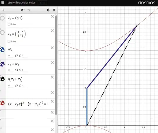

UPDATE:
Based on what you already wrote in (1) and (3),
one can construct an energy-momentum diagram, where the 4-momentum vectors are added tip-to-tail.
This represents the sum of the initial 4-momentums.
(The red hyperbola has center at the tip of the first 4 vector.)
That this hyperbola meets the opposite ends of the vectors means that these two initial 4-momentum vectors have the same magnitude (that is, each of the initial 4-momentums have the same rest mass). [This is the Minkowski analogue of an isosceles triangle!]
The vertical components are the relativistic energies.
The horizontal components are the relativistic momentums.
(Think of adding force vectors on a free-body diagram, or think of adding a sequence of displacement vectors (following a treasure map).)
The dotted segment represents the resultant vector.
This resultant vector is the total 4-momentum in the system "before", and must (by conservation) be equal to the total 4-momentum in the system "after".
Find the magnitude of that resultant vector, but use
not the Euclidean distance-invariant using the Pythagorean theorem $\sqrt{E^2+p^2}$
but the special-relativistic Minkowskian invariant $\sqrt{E^2-p^2}$
The magnitude of this resultant vector is the rest-mass of a single particle if the collision was totally-inelastic. (This is often called the "invariant mass of the system".) Once you have this resultant vector, you can find its energy and momentum components [in the frame of this diagram].
robphy-energyMomentum-1
If you have final particles (as opposed to a single particle), then the vector sum of the 4-momentums of those particles have to (by conservation) add up to that resultant 4-momentum vector.
If those final particles are photons, then the 4-momentums of those photons must be angled at 45 degrees (since each of those photons have its relativistic-energy equal to the magnitude of its relativistic spatial-momentum).
FOR YOU TO DO:
Starting from the origin, can you find two [4-momentum] vectors (with angles +45 degrees and -45 degrees) that vectorially add up to the dotted resultant vector?
Can you find the components of each of those [4-momentum] vectors?
For algebraic simplicity, it is probably better to work with frequencies rather than wavelengths. If you need wavelengths, do that at the last step.
(This is not that much different from the ordinary problems of adding vectors of forces or adding vectors of displacements.)
