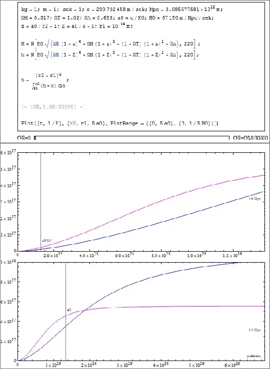

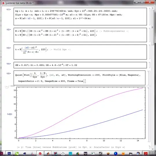

But the problem is, I then get about $8\times10^9$ years for the age of the universe, but it should be around $12\times10^9$ years (which I get when I set $\Omega_{\mathrm{R},0}$ to zero):
$\Omega_{\mathrm{R},0} = 4.8\times10^{-5}$: plot for first value of radiation content
$\Omega_{\mathrm{R},0} = 0 \to 0.00001$: plots for changing value of radiation content
Do I have to use some other models than FLRW/ΛCDM, or is one of my parameters outdated?

The total energy density is by definition $$ \Omega_{T,0} = \Omega_{R,0} + \Omega_{M,0} + \Omega_{\Lambda,0},$$ so with the values you cite ($\Omega_{R,0}=4.8\times 10^{-5}$, $\Omega_{M,0}=0.317$, $\Omega_{\Lambda,0}=0.683$), we get $\Omega_{T,0} = 1$, or in a more common notation $\Omega_{K,0}=1-\Omega_{T,0}=0$, i.e. a space with zero curvature.
It is also common to define the present-day value of the scale-factor as $a_0=1$, so that $$ H(a) = H_0\sqrt{\Omega_{R,0}a^{-4} + \Omega_{M,0}a^{-3} + \Omega_{K,0}a^{-2} + \Omega_{\Lambda,0}}. $$
The age of the universe can then be derived as follows: from $$ \frac{\text{d}a}{\text{d}t} = \dot{a}, $$ we get $$ \begin{align} \text{d}t &= \frac{\text{d}a}{\dot{a}} = \frac{\text{d}a}{aH(a)} = \frac{a\,\text{d}a}{a^2H(a)}\\ &= \frac{1}{H_0}\frac{a\,\text{d}a}{a^2\sqrt{\Omega_{R,0}a^{-4} + \Omega_{M,0}a^{-3} + \Omega_{K,0}a^{-2} + \Omega_{\Lambda,0}}}\\ &= \frac{1}{H_0}\frac{a\,\text{d}a}{\sqrt{\Omega_{R,0} + \Omega_{M,0}a + \Omega_{K,0}a^2 + \Omega_{\Lambda,0}a^4}}. \end{align} $$ Integrating yields the difference between the time that a signal is emitted and the time it is observed: $$ t_{\text{ob}} - t_{\text{em}} = \frac{1}{H_0}\int_{a_{\text{em}}}^{a_{\text{ob}}} \frac{a\,\text{d}a}{\sqrt{\Omega_{R,0} + \Omega_{M,0}a + \Omega_{K,0}a^2 + \Omega_{\Lambda,0}a^4}}, $$ and the age of the universe is $$t_0 = \frac{1}{H_0}\int_0^1 \frac{a\,\text{d}a}{\sqrt{\Omega_{R,0} + \Omega_{M,0}a + \Omega_{K,0}a^2 + \Omega_{\Lambda,0}a^4}}.$$ This should give you the correct age.
