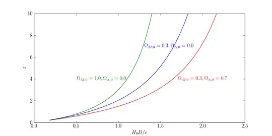

The effect of dark energy can be seen in this figure: enter image description here
Here, I've set $\Omega_{R,0}=0$ and $H_0 = 63.7\;\text{km}\,\text{s}^{-1}\,\text{Mpc}^{-1}$ (the most recently obtained value). The red curve is a model with dark energy. As you can see, for a given distance the corresponding redshift is much lower than in models without dark energy, i.e. without acceleration.

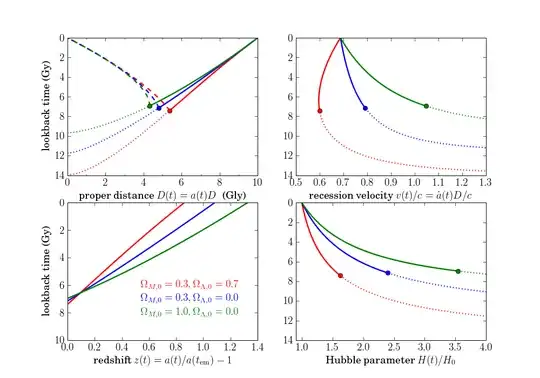

Let's apply this to a particular galaxy. Suppose we have a galaxy at a present-day distance $D = 10$ billion lightyears. We then have the following situation: enter image description here
The first graph shows the proper distance of the galaxy and its light $D(t)=a(t)D$ as a function of lookback time $t_0-t$. In all three cases, $D(t)=0$ corresponds with the 'big bangs' of these models.
The change from dotted lines to solid lines indicate the moment $t_\text{em}$ at which the galaxies emitted the photons that we observe today; the dashed lines are the paths of those photons. In all three models, the photons were emitted about 7 billion years ago. But the corresponding scale factors $a(t_\text{em})$ are very different: $a(t_\text{em})=0.54,\,0.48,\,0.43$ for the red, blue, green models respectively. This is a direct consequence of the different age of the universe in the three cases.
This immediately explains the redshifts shown in the graph below: the present-day redshift of the light is $z=0.86,\,1.1,\,1.3$ in the respective models, i.e. the observed redshift is much lower in the dark energy model.
Although it's not very clear, the red curve of $D(t)$ has an inflection point about 6 billion years ago, corresponding with the moment when $\ddot{a}=0$ and the expansion of the 'red' universe began accelerating. This is much clearer in the top right graph, showing the recession velocity $v(t)=\dot{a}(t)D$. In all three cases, $v(t)$ was much higher in the past, which means that the expansion has been decelerating. But in the dark energy case, $v(t)$ reached a minimum value around 6 billion years ago, and began to increase again. This is the effect of recent acceleration due to dark energy.
However, note that $v(t)$ is much lower in the dark energy universe. Again, this is a consequence of the age of the universe in the models: it took 14 billion years for $a(t)$ to increase from 0 to 1 in the red model, while it took only 9.7 billion years in the green model. As a consequence, $\dot{a}$ is much lower in the former case.
Finally, the last graph shows the Hubble parameter $H(t)=\dot{a}/a$, showing that even in the accelerating universe $H(t)$ decreases.
To summarise, the influence of dark energy determines the redshift, proper distance and the recession velocity over time, but it's not really its effect on the accelerating expansion that's important, but rather its effect on the age of the universe.
As a final note, the proper distance of a galaxy isn't directly observed. It can be derived from its so-called luminosity distance (comparing the apparent brightness and intrinsic luminosities of supernovae). So we should actually compare the evolution of a galaxy with a fixed present-day luminosity distance in different models rather than a fixed proper distance, but this doesn't change the argument.
