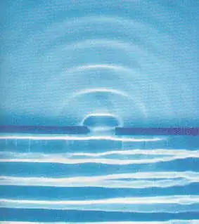

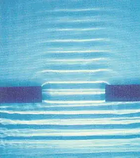

Why not? In terms of wave character, this can be explained easily using Huygens principle (as by Josh). Here's an image for on how the wavefronts emerge from both large and small slits...
In case of the large slit, the wavefronts are more and hence they arrive as similarly plane waves. Still, the curve can be noticed at the edge. Thus, the spherical wavefronts are significant only when the slit width is comparable to the wavelength of the wave - leading to "diffraction".

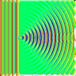

Here's an image from Wiki on how the spherical wavefronts interfere with each other...
