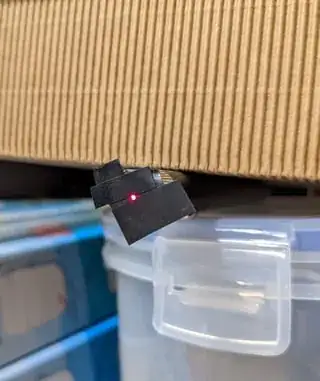

I tried to run the double slit experiment at home for my kid with a cheap red laser pointer. I partially covered the laser with four pieces of electrical tape to make a tiny square hole. To my surprise that was enough to get a cross shaped interference pattern on my wall with a splatter of other dots around it.

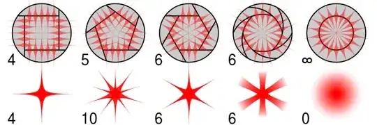

Try making a six sided hole and see what you get - 3 lines inclined at $60^\circ$ to one another?
It is due to the diffraction of light and called a diffraction spike or starburst effect in photograph as shown below.
If you do not want the starburst then use a circular hole.
