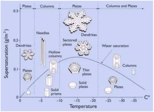

As the diagram given in the @JohnDumancic answer below demonstrates, snow crystals grow in the form of plates at temperatures from 0 to $-3^\circ$C or below $-10^\circ$. The question is thus essentially reduced to the typical conditions (temperature and water vapour saturation) that exist in the snow clouds.

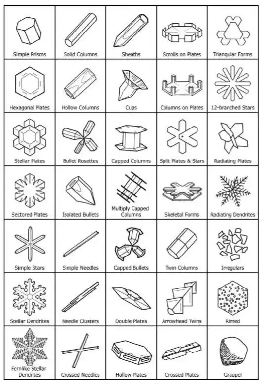

As an introductory aside, I'd like to answer this related question, for completeness's sake. The answer is, as you could probably guess, is a resounding no! There are an astonishingly large amount of ways snowflakes/snow crystals can form. Figure 10.3 from Dr. Kibbrecht's book shows a decent amount of ways the morphology of snow crystals can vary: enter image description here
This is just a selection of shapes! Snow crystals are enormously varied in shape and form. Do note that nice, symmetrical snowflakes are actually quite rare naturally; much snow falls in irregular crystal clumps. Figure 10.1 is a rough guide to what morphologies are likely to occur at differing temperatures and water-vapor supersaturation (asumming constant conditions; according to the author, "The 'water saturation' line shows the supersaturation found in a dense cloud of liquid water droplets"). enter image description here

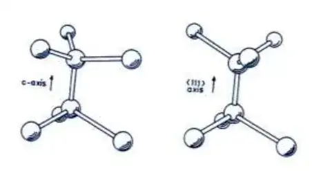

In water ice, the molecules orient themselves with respect to the polarity of the molecule; the partial charge on the hydrogen and oxygen atoms results in the Bernal-Fowler rules (there is always one hydrogen atom in between two oxygen atoms, and thus two strong and two weak O-H bonds for each oxygen atom). Due to the close similarities between the angle of a water molecule and the tetrahedral angle, water ice has a crystal structure that is effectively tetrahedral. There is an ambiguity in the crystal structure as shown in the diagram below (Figure 2.4 in the book): on the left is the structure of hexagonal ice, while the right has the structure of cubic ice (balls are oxygen atoms, sticks are hydrogen atoms). enter image description here

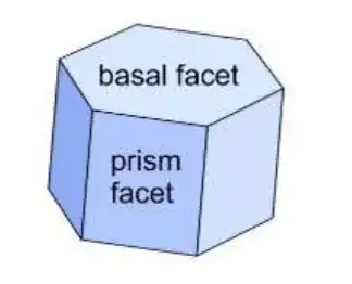

However, only hexagonal ice is stable in nature (at least in ordinary conditions), resulting in a fundamental crystal of the below shape (Figure 2.5):
The shape of this proto-snowflake is the fundamental cause of six-fold symmetry in normal snowflakes. Now that we understand the fundamental unit of a snowflake, let's see how it grows! Now, an important relation in snowflake growth is the Hertz-Knudsen relation, which states: $$v_n=\alpha v_{kin}\sigma_{surf}$$ where $v_n$ is the crystal growth velocity perpendicular to the surface in consideration, $\alpha$ is the attachment coefficient, $\sigma_{surf}$ is the water vapor supersaturation, and $v_{kin}$ is the kinetic velocity. The important quantity here is $\alpha$, which is a number between 0 and 1 and can be interpreted as a sticking probability of a water vapor molecule joining the crystal as part of the surface. These provide a very easy way to explain when flat snowflakes vs column-like snowflakes form (as seen in the charts in the preceding section). When $\alpha_{basal}\gg\alpha_{prism}$, water vapor piles onto the tops of the protocrystal, forming columns. When $\alpha_{basal}\ll\alpha_{prism}$, water vapor sticks to the sides, forming flat, platelike crystals. This leads to the development of nucleation theory. We have a simplified model that states $$\alpha(\sigma_{surf})=\exp(-\sigma_0/\sigma_{surf})$$ $$\sigma_0\propto\frac{1}{T^2}$$ where $\sigma_0$ is a dimensionless constant. The exact dynamics behind $\alpha_{basal}$ and $\alpha_{prism}$ are beyond the scope of this answer (there are a lot of nontrivial effects that scorn our attempts at a nice, pretty model); consult chapter 3 of the book for more information. However, in summary, certain pressure/temperature conditions result in different values for $\alpha_{basal}$ and $\alpha_{prism}$, which is the root behind the formation of column or flat snowflakes.
