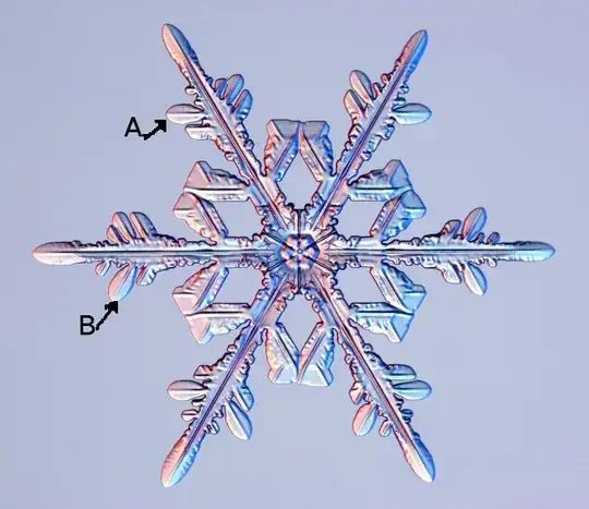

Suppose the snowflake at one moment is perfectly symmetrical. Then suppose a random molecule gets added at point A. To maintain the symmetry, later on a random molecule gets added at a corresponding point B (and four others). But the motion of the water molecule is random and there is no reason for it to end up at B or anywhere else in particular.
Even considering theo's remarks about dendrite growth, why don't we see this?
I see absolutely no reason why any given additional water molecule cannot land in an energetically unfavourable position. Besides, if low energy considerations were a driving force, snowflakes would be approximately spherical.
So, what's really going on? How can a bump at A create an attractive force at a distant B?

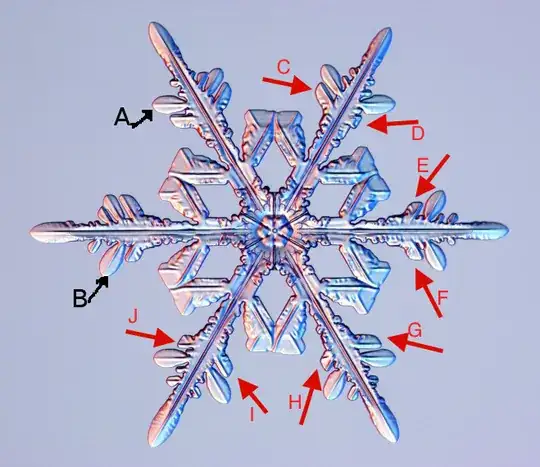

But we do see exactly the kinds of asymmetries that you're asking about, even in your sample image. Here it is again, with some more letters and arrows:
annotated snowflake
If the ice crystals are more or less confined to a plane, you expect the crystal to be symmetric under rotations of 60º (one-sixth of a turn) and reflections about six axes in the plane. That's clearly approximately true for this snowflake. But look at the second biggish lobe on each long arm.
  • A reflection with lower-left to upper-right arm as its axis would swap $C\leftrightarrow D$ and $I \leftrightarrow J$, but those lobes are different sizes.
  • A reflection about the orthogonal axis would swap $C\leftrightarrow J$ and $D\leftrightarrow I$, but those lobes are different sizes.
  • A rotation by 60º clockwise would take $B\to A$, which as you point out are the same size, but would also take $(C,D)\to(E,F)$, which don't match.
If I had better image manipulation tools and a lot of free time I would overlay rotated and reflected images on each other to make the differences more obvious, but I think you should have the point. The asymmetries are there, but they are smaller than you expected. And there's a strong bias towards publishing photographs of exceptionally symmetrical flakes like this one. Libbrecht, who may have taken that image, puts it nicely:
