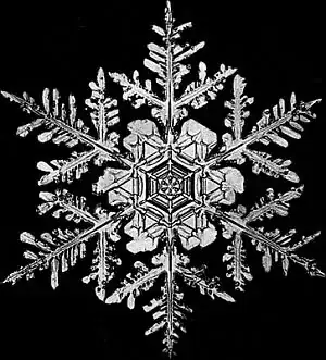

A snowflake differs from a big chunk of ice by its being small. Even more importantly, it is in the process of growing. You should think about the process in which the snowflake was created.
At the beginning, it was small. A few atoms formed a small piece of crystal. Such a small piece of crystal almost always has some hexagonal (or different) symmetry. What happens if you wait for a little while and it continues to freeze?
Well, the water molecules are added to the crystal because it's energetically favored: vapor turns into ice - and you need vapor to create snowflakes because liquid water freezes differently.
Nature adds one water molecule at a time. The molecules always try to choose the most energetically favored position on the frozen body. Because these laws of creation of a snowflake are symmetric with respect to the rotational symmetries, it follows that any symmetry that exists at the beginning - a hexagonal symmetry of a small number of molecules in the initial crystal - will be preserved. It's pretty much inevitable that all the arms are growing approximately equally, so the initial symmetry group is preserved and becomes a symmetry of a macroscopic object.
The more difficult question is actually why the snowflakes are so diverse and beautiful. Most likely, it is not an accident that they achieve one shape or another. Changing pressure, temperature, or humidity as a function of time changes the conditions that determine the optimal places where the new vapor molecule should be added. But even if pressure, temperature, and humidity depends on time, the hexagonal symmetry is still maintained.
