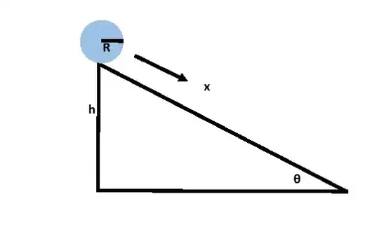

Consider a round body (sphere, cylinder, etc.) rolling down an incline, starting at rest, as shown in the following figure.
Assume the body rolls without slipping. Basics physics texts, evaluate this case using both the equations of motion and work/energy, and show the total energy at the bottom of the incline is the same using either approach. For this case of pure rolling of a rigid body, friction does no work, as sometimes explained by the fact there is no relative motion (no sliding) between the point of contact of the body and the surface of the incline. The only force that does work on the body is gravity, so the total energy at the bottom of the incline is $mgh = {1 \over 2}mv^2 + {1 \over 2}I \omega^2$. Since the body rolls without slipping, $\omega = v/R$, and $mgh = {1 \over 2}mv^2 + {1 \over 2}I v^2/R^2$. The total kinetic energy is partitioned between the kinetic the kinetic energy of the CM and the rotational energy about the CM. Since only gravity does work, the total kinetic energy is the same as for the case of a frictionless incline, $mgh$, except with no friction the total kinetic energy is the kinetic energy of the CM and the rotational energy about the CM is zero. So, for pure rolling friction- contrary to the case with no friction- although friction does no work it causes the kinetic energy of the CM to decrease and the rotational energy about the CM to increase. This is explained by considering the two terms for the work done by friction. The work by friction on the CM is $-\int F_{fric} dx$, negative since friction opposes the x motion; the work by friction with respect to the CM is $\int \tau_{fric} d \theta = \int F_{fric}R dx/R$, where $d \theta = dx/R$ with no slip. The first term decreases the kinetic energy of the CM and the second term increases the rotational energy about the CM, but the sum of the terms is zero since the net work done by friction is zero. Although friction does no work in total, the total work has two components; one component decreases the kinetic energy of the CM and the other component increases the rotational energy about the CM. For rolling without slipping, the sum of the two components is zero.

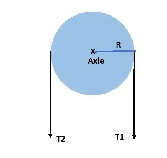

3. Pulling on a pulley
As a trivial example, consider a pulley rotating about an axle fixed in the inertial frame through its CM, with mass $m$ and moment of inertia $I$, as shown the following figure.
The rotation is due to unequal tensions $T_2$ greater than $T_1$ on a rope that causes rotation. The axle provides a force of constraint $\vec F_c$ upwards equal in magnitude to $T_2 – T_1 + mg$ to keep the CM fixed. Friction between the rope and the pully- assuming no slip- causes rotation, therefore the tension forces can be regarded as frictional forces on the pulley. Assuming no initial rotational motion, using the equation of motion for the pulley after time $t_1$, the total angular distance traveled is $\theta_f = {{(T_2 – T_1)Rt^2} \over{2I}}$, and the rotational energy is ${(T_2 – T_1)^2R^2t_1^2}\over {2I}$. Using the two-term relationship for the work by friction, the first term- for the kinetic energy of the CM- is zero since there is no motion of the CM due to the force of constraint. The second term is the kinetic energy for rotation about the CM up to time $t_1$ is $ \int_{0}^{\theta(t_1)} (T_2 – T_1)R d \theta = (T_2 – T_1) R \theta_f$. Using the earlier result for $\theta_f$, this is the same result as obtained from the equation of motion for rotation.

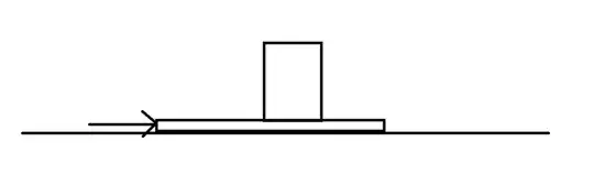

No slip does not mean that friction does no work. Here is a block resting on a slab resting on an ice-skating rink: enter image description here
When I push the slab along the ice, the top block does not slip on the slab. Static friction does work to change the block's kinetic energy.

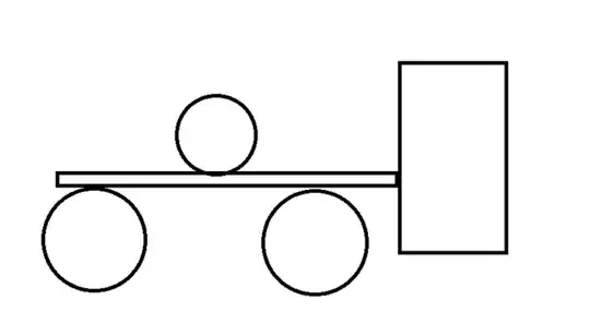

Here is a cylinder in a truck bed: enter image description here
When the truck accelerates forward, static friction drags the cylinder forward and rotates it counter-clockwise, the cylinder rolls without slip off the end of the truck. Static friction did work during roll without slip.
