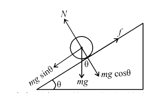

  1. Slipping means there is relative motion between two surfaces. Only when $v=r\omega$, there is no relative motion between the surface of the rolling object and the surface on which it is rolling and hence no slipping. In other cases, when $v\not=r\omega$, there is relative motion between the surfaces and hence slipping as well.
  2. If the wheel starts rolling on the smooth incline, the wheel will be accelerated linearly due to the force of gravity on it without its angular velocity being affected (as there is no friction to exert the required torque). As a result, after the starting point, $v\not=r\omega$ and the wheel will stop rolling and start slipping.
  3. If there is SUFFICIENT friction on the incline, the friction force will be able to exert the required torque and the wheel will continue rolling on the incline.

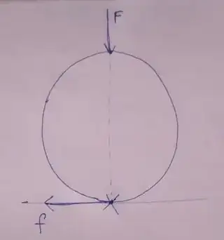

  4. If some net external force other than friction happens to act on the rolling body such that the external force vector is at some perpendicular distance from the point at which the friction is acting as in the case of rolling on incline,enter image description here
Then in that case, we can't apply conservation of angular momentum. However, if no external force other than friction acts or if the net external force other than friction acts in such a manner that it is directed towards the point at which the friction acts (perpendicular distance of the force from the point of application of friction=0) like in the figure,
Then we can apply conservation of angular momentum about the point of application of the friction (since torque due to friction and the external force about the point will be zero).
