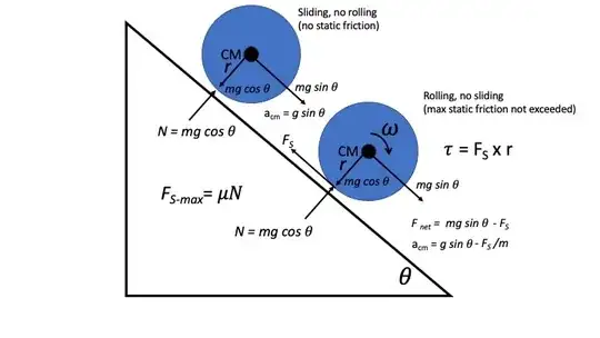

It is the static friction force that causes the torque about the CM, not the weight. The torque $\tau$ caused by the static friction force $F_s$ where the radius of the cylinder is $r$ is
$$\tau = F_{s}r$$
The weight limits the maximum possible static friction force. If the maximum static friction force is exceeded, the cylinder will start to slide.
The maximum possible static friction force is
$$F_{s-max}=\mu N= \mu mgcos\theta$$
Where $\theta$ is the angle of the incline and $\mu$ is the coefficient of static friction. In order for the cylinder to roll without sliding,
$$F_{s}<\mu N$$
I have included the free body diagrams below of the cylinder sliding without rolling and rolling without sliding.
