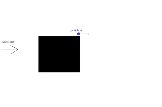

Consider airflow around square object, when an air particle A comes to the rear edge of an object. It is very logical that the particle would not turn at 90 degrees and follow back side of object, because inertia keeps it from going in a straight line (by Newton's first law). Same thing happens at a wing when AoA is too "sharp" for air to follow wing surface.
Why is then flow separation described by adverse pressure gradient?

There's another point that I need to bring up about your specific example of the flow over a square cylinder. In that instance, we usually don't consider it to be a "flow separation" problem in the same sense as a boundary layer detaching from a wing at high angle of attack.
In the square cylinder, the flow is attached to the surface over the entire top side and then it doesn't turn 90 degrees because there is no force acting on it that is strong enough to make it turn 90 degrees. Instead, it gradually starts to turn because the pressure in the wake of the square cylinder is lower than the pressure outside the wake -- there is a pressure gradient in the vertical direction, which is the force that turns the fluid.

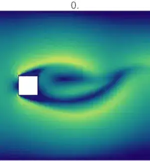

Just to illustrate the question about flow around square cylinder we compute animation with using stable fluids algorithm. Please, pay attention that separation line starts from the leading edge, and not from the rear one.
Figure 1
